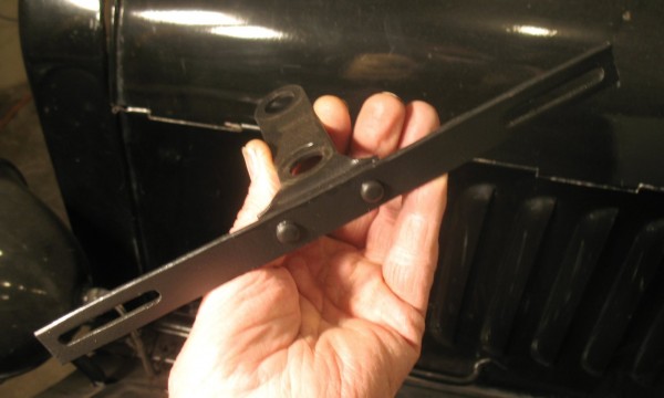

Post by Steve Jelf » Tue Mar 12, 2019 11:50 pm
This one fits the 1921-1927 spring clip. You could make something similar to use the 1920 and earlier spring clip, but it would need to have a jog up or down to miss the crank handle.

Re: mount front license plate
Post by sheppfour » Wed Mar 13, 2019 6:51 am
Thanks, I'll have to make one with some drop to clear the crank

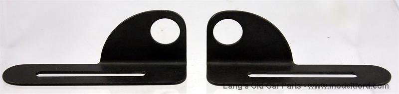

Post by Jim Sims » Wed Mar 13, 2019 10:28 am
The 19 uses a two piece mount. Part number 3664e in Langs catalogue.

Post by jsaylor » Wed Mar 13, 2019 12:56 pm
Here is the one Lang's sells[.
