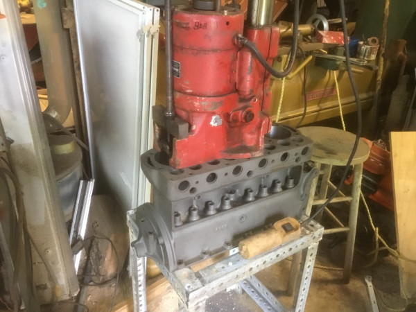

In-chassis boring equipment is still available; the problem is that it is pricey. A really good automotive machine shop might have one, but if you live anyplace except in a major population center, good luck finding a shop that has one. There is no reason why a T engine could not be bored in-chassis.

Anyone with a boring bar could set up in the car. But my goodnesses, how could you ever get it cleaned enough not to self destruct?
. And what about the babbitt?-

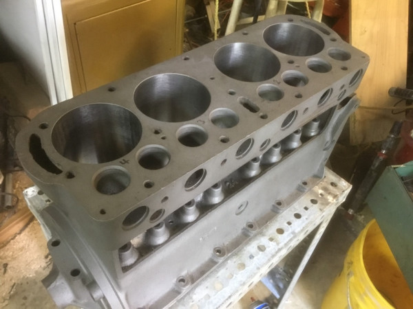

Ford used an unusual step in finishing Model T bores. The name for the process may be "Brinelling". It amounted to mechanically surface hardening the cylinder bores, and probably made the bores very wear resistant. Original builds also used wide, soft cast iron rings, which didn't wear very well, but were very easy on the bore surface. Very few model T engines today have the orignal bore intact and in good condition, and many of them have been through more than one rebore and have been equipped with "modern" rings. That said, I've seen wear ridges in Model A blocks, many flathead V8 blocks, and any number of other engines, including Y block and FE Fords, Chevrolet 6s, and others. If a ridge is present, it indicates bore wear is present. If a ridge is not present, it may indicate minimal bore wear, or it may be due to a ridge having been presnt and been reamed out during a previous rebuild. Measuring the bore will determine the true condition. Some bore wear is acceptable, but none is best. I have had very badly worn engines that ran well and had lots of power, but used absurd amounts of oil and were capable of laying down a smoke cloud a quarter mile long. A particular 389 Pontiac V8 in a '64 Bonneville convertible comes to mind... The car cost me $75.00. I had a million dollars worth of fun with it.
- Posts: 5431
Re: Losing power..
Cast iron piston top ring comes all the way to the top of the hole, aluminum without checking, within a nats ear. So there should be no ridge ring, bore would be worn all the way from top to bottom, generally more at the bottom because of the way the piston rocks going past center. Wearing the bore oval shaped. The bigger dimension being in line with rod travel.
- Posts: 7901
Re: Losing power..
Regardless, there is a brisk trade in oversize Model T pistons, even 100 years on.

If the bores as worn, you should notice the piston slap. If not, maybe .010 oversize (from marked on piston top) piston rings might work. Hone & fit/file to each bore. If that is your problem. What I dont get is the piece meal repairs. When I get a new T that has Issues pointing to lots of use, I go thru the engine/transmission completely. Once. Until I wear it out again.

I worked in a Ford dealer in the early 1960's. On several occasions we had cylinders bored in-chassis. Getting the cuttings out of the engine was not an issue. The machinist would mask the entire sealing surface of the engine block except for the cylinder to be bored. He would then mask the crank with carefully taped plastic. Before any masking was removed he would co over everything very carefully with a vacuum cleaner. We never had any problems.BobShirleyAtlantaTx wrote: ↑Sun May 23, 2021 11:56 amAnyone with a boring bar could set up in the car. But my goodnesses, how could you ever get it cleaned enough not to self destruct?BE6E6E90-F2FA-474B-9165-27CC302B7450.jpegE13EEFB0-7FC2-48B0-8332-0FF5E3C85831.jpegEB4D6728-5C98-4CCF-B583-46D9492F8E63.jpeg. And what about the babbitt?

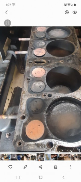

Re: Losing power..

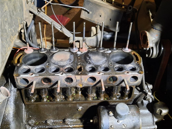

So... I took it apart this evening... intake valves look ok, intake not so much.. also I can feel ridges halfway down in all 4 cylinders... I guess that means rebuild job, right ?

Re: Losing power..
It's good you pulled the head to look. I'm not an expert, but those exhaust valves look like they were very hot. Maybe something happened to cause the ignition timing to back off. That would cause the extreme heat and a definite lack in power. Plus... after that happened they probably weren't sealing well either. So when you get it back together, I'd double check the ignition timing. Bill

Re: Losing power..
It means the valve job didn't take
you might have some scratches 1/2 way down the bore, but you don't have ridges. Nearly all old T motors have scratches...some even have gouges from wrist pins gouging them. In most cases, it is meaningless relative to performance and very often doesn't even result in excess oil consumption. I've replaced rods for guys who are determined to not spend a dime more than the price of a rod and a couple hours of work...in most cases, even the gouged cylinder jobs ran passably well.
Proponents of valve grinding paste not always, but very often end up wrecking new valves and ironically never fully clean up the block anyway, and are the primary recipients of hardened seats and a full rebuild...if they had used a NuWay set and done the job (which does NOT require a finish grind), there would be far fewer "sunk" valves and far fewer hardened seats sold.
You may very well need to have the motor completely rebuilt, but there are plenty of folks who could put that thing back on the road for another 5 - 10 years with very low risk. Unless you have a burning desire to spend $4,000 - $6000 bucks on a rebuild, find one of those folks.

Re: Losing power..
I’m as cheap as anybody but those seats are really deep, I would consider hardened seats at least. Looking at the 1st picture of the block those look like 2 piece valves. I don’t recall seeing holes on new valves for seating. If your bores are good and not too egg shaped you may be able to hone and add Aluminium pistons & rings while you’ve got it apart. That said, to consider the above, your rods need to be good and still have some shims left on them plus find the right sized pistons if you’re already running oversized stock pistons. Cheap however isn’t necessarily inexpensive. Good luck.

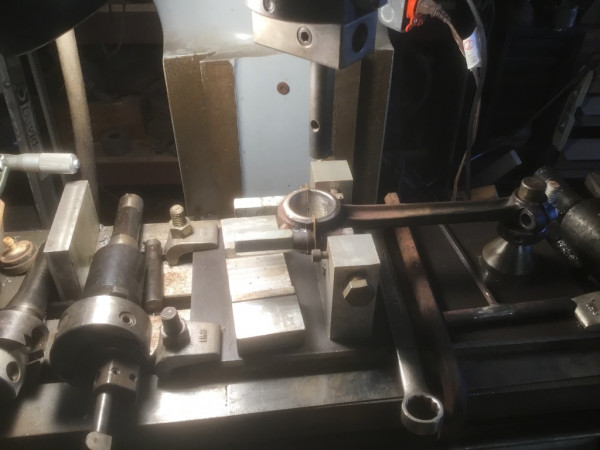

- Posts: 6596
Re: Losing power..
Larry, I'll warn you that if you simply run a reamer down the hole without fixturing the reamer dead center on the valve hole (or where it SHOULD be since the last set of valves were lapped in with excess wobble/clearance), and then CUTTING a new valve seat, you are not going to come to a good end.
There will undoubtedly be someone who will cheerfully suggest that "nah, you only have to whale-away at the block with a couple of stones after you've reamed it and you'll be fine". If you take that advice, well the advice was free, just like mine.
http://www.mtfca.com/discus/messages/70 ... 1510948496 shows how I do it, and how others do it similarly, as well as a period tool which did the same thing as I and others do. All good engineering practice and you're guaranteed concentricity between the valve guide and the valve seat (which is absolutely vital once the guide/valve tolerances are back in spec).
I really cannot too strongly suggest that you get help with this from someone who is acquainted with this type of work. Pretty sure I said the same thing when you were first replacing the valves and sincerely hope that you will take the advice now.

So I got a valve job done, with what I am happy with.. compression is between 35 and 40 in all cylinders...car starts easy, idles nice.. However I still seem to have an issue with power.. Here is some info, see what you think...number 2 and 3 cylinders seemed to have burnt valves, as in running lean, when I start the motor and adjust the fuel I go clockwise to lean, (which is about one turn out) then turn counterclockwise to to get more fuel I can turn all day little or no change( 3 or 4 turns ) is that normal ? I thought I should be able to flood the thing ... I have a rebuilt holley vaporizer.. any suggestions ??
- Posts: 4955
Re: Losing power..
Does it have a new viaton needle & seat? These seats are drilled too small, compared to original. They dont flow enough fuel. That would definitely create a lean no power situation.
Pull the bowl & check for a black rubber tip on the needle. A proper hi flow version is available on the parts forum.
Being a vaporizer has its own possible issues. There are those here that like em, run em & know what to look for with them.
- Posts: 4955
Re: Losing power..
Aside the probable lean fuel condition, your compression readings are very low. I realize a 27 vaporizer motor has the least compression of all the T series, but, cant be that low. A stock blue printed Montana motor has 60#. I am saying you still have an issue there.Larry e rutt wrote: ↑Mon Jul 12, 2021 4:53 pmSo I got a valve job done, with what I am happy with.. compression is between 35 and 40 in all cylinders...car starts easy, idles nice.. However I still seem to have an issue with power.. Here is some info, see what you think...number 2 and 3 cylinders seemed to have burnt valves, as in running lean, when I start the motor and adjust the fuel I go clockwise to lean, (which is about one turn out) then turn counterclockwise to to get more fuel I can turn all day little or no change( 3 or 4 turns ) is that normal ? I thought I should be able to flood the thing ... I have a rebuilt holley vaporizer.. any suggestions ??

Topic author - Posts: 154
- Joined: Wed Jan 09, 2019 4:52 pm
- First Name: Larry
- Last Name: Rutt
- * REQUIRED* Type and Year of Model Ts owned: 1926 fordor
- Location: Ephrata pa
Re: Losing power..
Nice... I got my power back and then some... repair included, valve job, dirt in carburetor, spark plug wire to the 4th cylinder to close to the coil box bracket... now I can pull hills.. thanks for all the advice..
- Posts: 4955
Re: Losing power..
Thats great! Now go drive the wheels off.Larry e rutt wrote: ↑Fri Jul 16, 2021 8:31 amNice... I got my power back and then some... repair included, valve job, dirt in carburetor, spark plug wire to the 4th cylinder to close to the coil box bracket... now I can pull hills.. thanks for all the advice..
