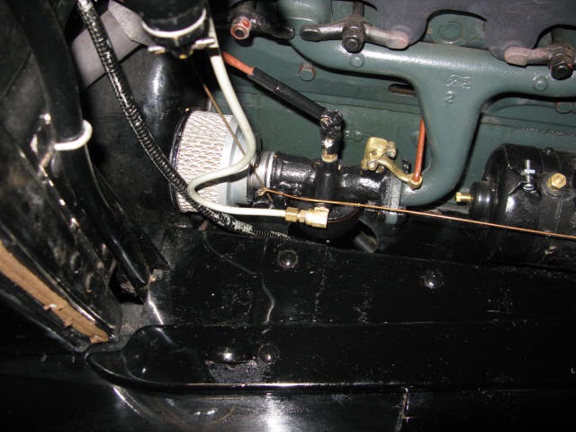

I drive on country roads a lot, so I use a filter on both the NH and the G.
Like this: http://dauntlessgeezer.com/DG116.html.

Steve,
Thanks for the details which I have documented in the attached. Your install is simple and mounts vertical and above the carburetor, which is what I prefer based on the warnings I have read concerning the possibility of flooding and soaking the filter. I will implement this as soon as I get a 'round tuit'.
Hurst
Hurst

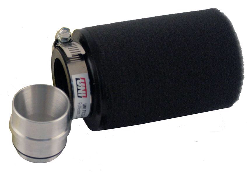

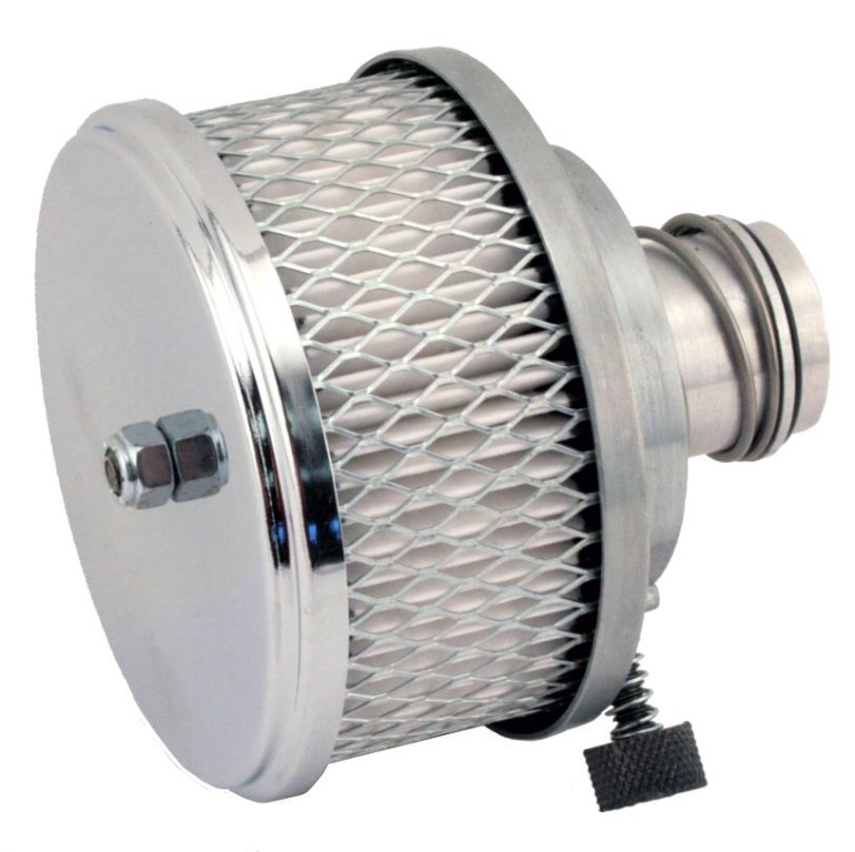

Here are the two types of Model T air filters available from Snyder’s. The pleated air filter has a lot more surface area and will filter a lot more air than the foam filter, the pleated air filter can be dismantled and cleaned by blowing out from the inside as often as needed. Jim Patrick

I recently installed a filter like the bottom one in the previous post. I just came back from a three day, 327 mile tour in NE Wisconsin and can report the following: 1.) Temperatures ranged between 45 and 65 degrees - prime temperatures and humidity for carburetor icing... no apparent Carb ice detected. 2.) Mileage increased to 18 mpg from 15 mpg. The car ran well, lots of power. So far so good. I carry the carb stove under the back seat but for now I'm sticking with the filter.
