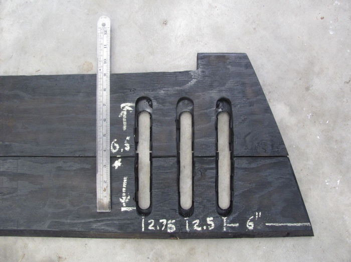

Easiest way is to remake the upper boards with the narrow pedal spacing. Wouldn't mess with changing pedal, the Improved Car pedals have different foot support shape and different bend in the shanks to fit the wider spaced big brake drum in the Improved Car hogshead.
Here's the spacing you can cut into new pair of upper boards.

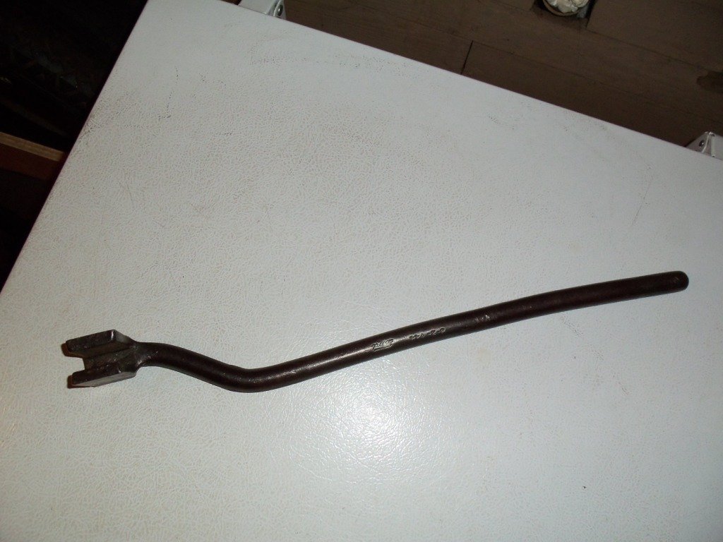

- Posts: 5424
Re: Welding a low speed pedal arm
This is a Ford script Z tool for bending pedals - I highly doubt "heat" would be used inside the cockpit !
