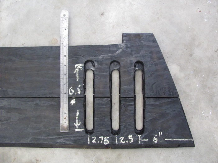

Why not just make new floor boards if you don't want to pull and swap out the pedal? Seems to me that would be a lot easier then cut well and hope it does not break. That way you would not harm your originals.

I believe I would keep the original floorboards and make or buy some new ones. That would be easier. Use the original floorboards as a pattern and alter the opening on your replacement floorboards to fit your 25 engine pedal.

Easiest way is to remake the upper boards with the narrow pedal spacing. Wouldn't mess with changing pedal, the Improved Car pedals have different foot support shape and different bend in the shanks to fit the wider spaced big brake drum in the Improved Car hogshead.
Here's the spacing you can cut into new pair of upper boards.
