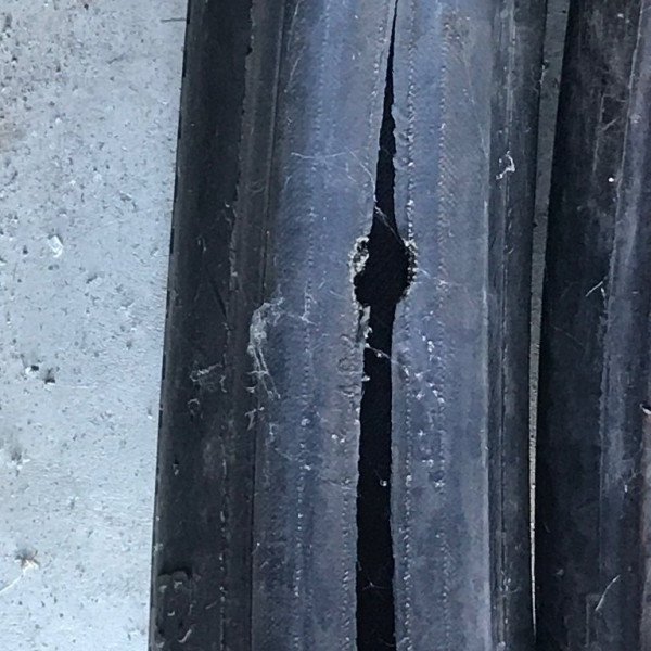

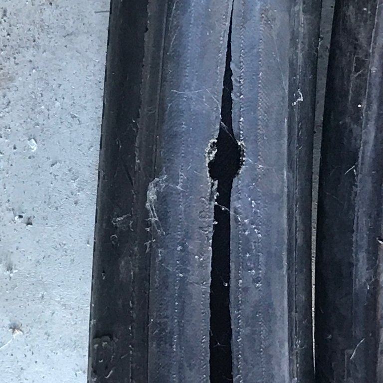

Re: Clincher Rims and Rubber Valve Stems
I had to ream the holes in my rims slightly to accommodate the rubber stems. No problem with the felloes. Another word of caution, grind a little relief in the tire bead where the valve stem goes thru. I didn't and had two of my tires go flat because the bead cut the stem.
I should have taken a clue from the 40 year old tire I took off (pictured)

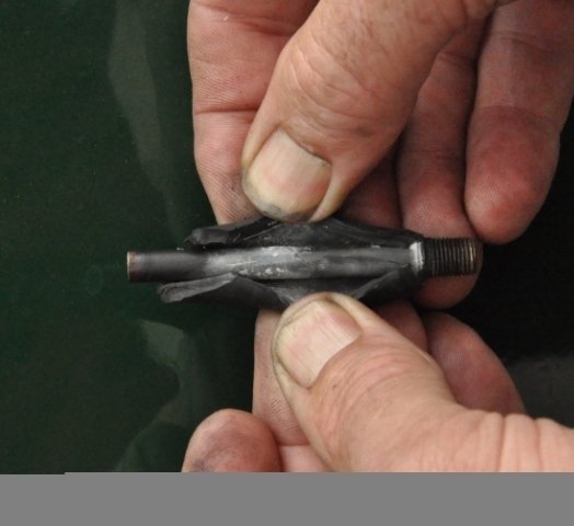

Ok now that you are going that route, here is how to do it;
http://sheepisland.com/cars/tech/metal_stems/
