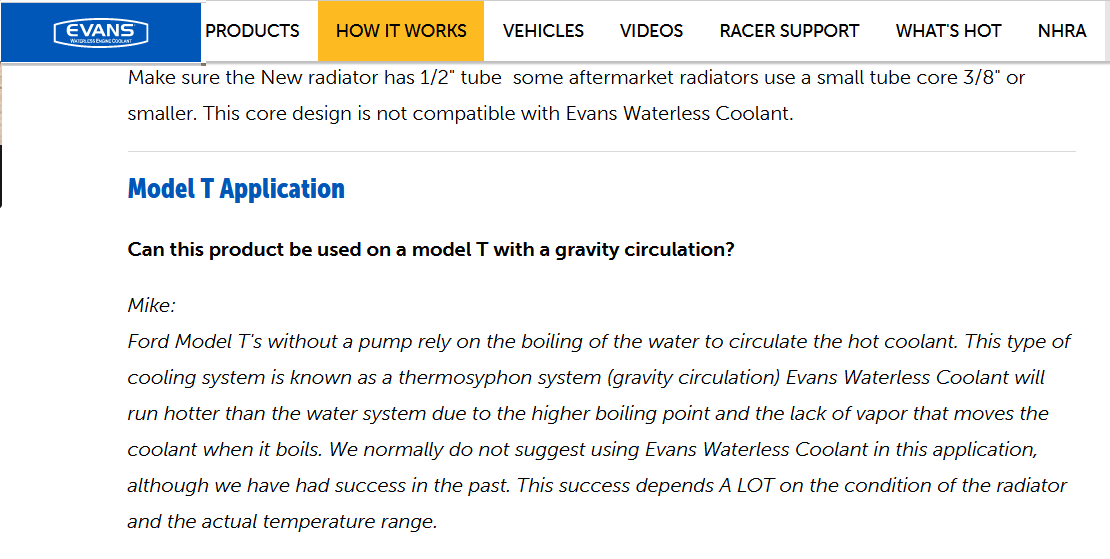

Terry, with all due respect, you need to do some more research on Evans coolant.
Even Evans discourages the use of their coolant in a Model T: "Ford Model T's without a pump rely on the boiling of the water to circulate the hot coolant. This type of cooling system is known as a thermosyphon system (gravity circulation) Evans Waterless Coolant will run hotter than the water system due to the higher boiling point and the lack of vapor that moves the coolant when it boils. We normally do not suggest using Evans Waterless Coolant in this application, although we have had success in the past. This success depends A LOT on the condition of the radiator and the actual temperature range."
When a manufacturer of anything claims it is the best there is, I view the claim with skepticism until I find evidence supporting their claim. On the other hand, when a manufacturer of anything claims it would be well to avoid in in my case and provides the reasons why, I'm inclined to believe them.
Lang's (and I'm sure others) carries this product and they state: "This waterless coolant allows engines to tolerate running hotter without boiling." Note - it will NOT boil; it WILL run hotter. Kudos to them for their forthright honesty (which I consider to be one of their trademark qualities). Considering that Evans' specific heat is around .65, or 65% as efficient as water, there is no conclusion to come to other than it is not suitable for a system DESIGNED for water (or as we typically use them, water-equivalent coolants).
OK, OK, I relent...at a 375F boiling point, perhaps there is someone on the planet that could drive a T to the point of complete melt-down. That would make for an interesting post and would not garner much sympathy from me...that would be an excellent example of getting what one deserved.
If someone is looking to cook their oil and deal with associated issues, this is the product for them.

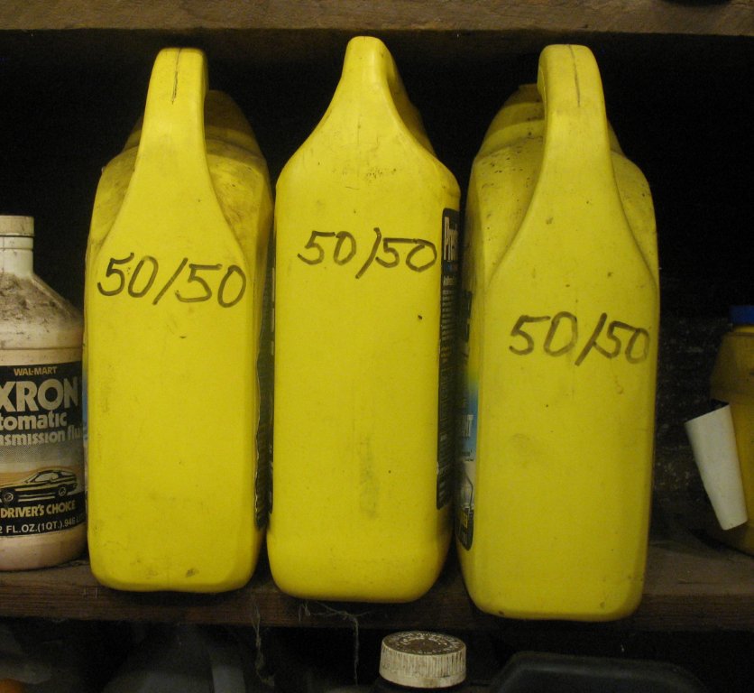

While it is easy to mix anti freeze in a pail as Steve suggests, the occasional top-ups are less easy to judge. Are you going to mix a batch each time? How much will you need? What do you do with the extra?
The extra.

Re: Ideal T antifreeze/coolant???
That's what I do as wellSteve Jelf wrote: ↑Thu Jun 03, 2021 2:42 pmWhile it is easy to mix anti freeze in a pail as Steve suggests, the occasional top-ups are less easy to judge. Are you going to mix a batch each time? How much will you need? What do you do with the extra?
The extra.![]()

Answers to two questions.
1. The top tank is hotter than the lower tank. That is normal. As the thermosyphon is caused by the hot coolant rising inside the engine to the top of the tank. As it cools it moves down to the bottom tank and goes back into the engine to repeat the circuit. With a newer car, you have pressurized cooling system and a water pump which circulates the coolant as long as the engine is running. That is why the newer cars have a thermostat which opens when the coolant reaches a certain temperature.
With a water pump on a good functionating Model T, the coolant will rise too fast and cool too much. The thermosyphon system is self circulating. It won;t begin to rise until the coolant starts to heat up. And after you stop the engine, it will still rise a bit right at first. That is why it tends to gurgle for a few seconds after being turned off on a hot day.
2. This is what you do with the "extra"? Save it to add as needed. Good to take some along on a tour just in case you need it.
Terry : ... About 20 years ago, we had the engine rebuilt, got a new radiator, new rubber hoses ( that were replaced several times from leakage,, interior was too smooth to metal ) , and went forward to use the Evans coolant. A factory representative came to my home to check over the engine and installed the Evans Coolant. Engine ran great, with absolutely no hot gurgle . Ran great for several months before those rubber tubes started to burp & leak...Yes, I needed more Evans because to the leakage but coolant he;d a constant level after replacing the rubber tubes. I am told that recent Evans coolant applications were to be used with coolant engine pumps and not without....... I have not had any problems using Evans without coolant engine pumps .... engine coolant level has been constant.. except coolant loss from quick stops due to very quick brake and coolant loss from leakage from the radiator cap due to the stop force. Just remember the salvage of Evans when doing engine/radiator, as after your repair the Evans coolant that was drained before engine work will be put back in repaired engine after filtering to check that any stuff from the engine is removed.
The engine has been running at least 20 years with a cooler engine and better performance.... just my truthful experience.
Yes, it Evans has a cost, but in my estimation is a better answer of a permanent engine protective coolant.

Bob
that is an interesting and informative report. Is it safe to assume that the radiator was new or nearly new 20 years ago when the Evans was first introduced into the system? round tube or flat tube radiator?
With such a low thermal efficiency as Evans has, I'd think your cooling system was/is top notch. That would be a very important factor to know, for those contemplating making such a switch.
... THE NEW RADIATOR was a 5 round core , replacing the original 3 round. The information 20 years ago indicated standard factory coolant was OK for the Evan's to work, .... recent info from Evans is requiring usage with water pump..... so lack of a water pump , in their estimation, will not lead to any coolant problems. In all these years, the engine has run without a water pump with no problems. My experience.

I prevent cooling system problems by using nothing but a 50/50 blend of Perrier water, pure Catalonian olive oil, poached and pureed quail eggs, and Gilbey's London Extra-dry Gin fortified with a sparkling drop of Retsyn! My radiator never boils as I enjoy faster accelleration, higher top speeds, and super fuel economy using the cheapest gas in town!
- Posts: 7398
Isn't that a 50/50/50/50 blend?
- Posts: 8444
I don't know. I had to proof-test the gin, just to be safe, and.... got any Alka-Seltzer?
Hello Ladies and Gentlemen,
Thank you for all of your responses. I had expectations regarding potential replies. With the exception of about a half dozen posts, you did NOT disappoint me.
Thank you Bob Jablonski for your story. You have confirmed my expectations.
As was stated, Evans is up to 90% ethylene glycol. From the Evans web site, it is stated there will be a 6-8psi pressure increase when the coolant warms up to operating temperatures. This means the coolant expands to increase pressure. Expansion directly correlates to density. The hotter the fluid, the less dense it becomes. Thus, a thermosiphon flow has a great potential for occurring. Being as Evans is up to 90% ethylene glycol, it would appear it would work very much the same as a standard mix of ethylene glycol coolant. With the added corrosion package and the total lack of water, the corrosion resistance should be outstanding as compared to any water diluted products.
My plans are to completely rebuild the engine, add an aluminum head, add a new, quality, radiator, and am considering whether or not to add a water pump (most likely will since water pumps were a period appropriate aftermarket option). In understanding period appropriate water pumps, I find the clearances and impeller construction designs leave a whole lot of room for thermosiphon flow when not operating. Much different than modern pumps. My most important concern is galvanic corrosion between the block and aluminum head. I have experience with this type of corrosion and common prevention methods. Using an anode is problematic. The anode requires replacement on a regular basis and will leave corrosion products in the coolant that will foul the radiator and coolant passages.
