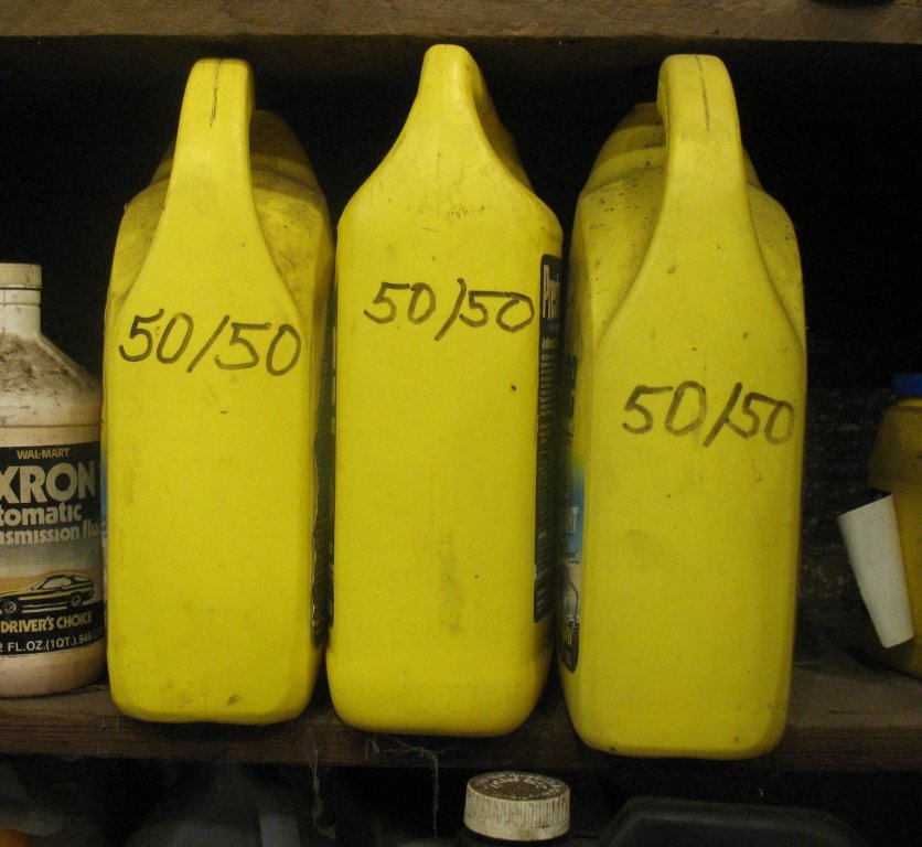

On one of the FB Model T pages, one guy said he uses pre-mix because he didn't want to make a mistake in mixing. Mister Thrifty is happy to take that risk to save a few bucks. :D
Some other product may indeed cool a Model T more than 50/50 does. But does it need to? Does a T need to run cooler than 50/50 allows? No.
Some other product may raise the boiling point. But does it need to? If a T runs on 50/50 without boiling, as mine do, no.
I have no trouble dumping a gallon of straight antifreeze and a gallon of distilled water into a pail. It ain't rocket surgery. Both are available everywhere and are inexpensive. The resulting 50/50 cools my engine adequately and contains anti-rust ingredients. What's not to like?

While it is easy to mix anti freeze in a pail as Steve suggests, the occasional top-ups are less easy to judge. Are you going to mix a batch each time? How much will you need? What do you do with the extra?
The extra. :)

Re: Ideal T antifreeze/coolant???
Post by RustyFords » Thu Jun 03, 2021 4:02 pm
Steve Jelf wrote:
Thu Jun 03, 2021 2:42 pm
The extra. :)
That's what I do as well
Post by Norman Kling » Thu Jun 03, 2021 4:37 pm
Answers to two questions.
1. The top tank is hotter than the lower tank. That is normal. As the thermosyphon is caused by the hot coolant rising inside the engine to the top of the tank. As it cools it moves down to the bottom tank and goes back into the engine to repeat the circuit. With a newer car, you have pressurized cooling system and a water pump which circulates the coolant as long as the engine is running. That is why the newer cars have a thermostat which opens when the coolant reaches a certain temperature.
With a water pump on a good functionating Model T, the coolant will rise too fast and cool too much. The thermosyphon system is self circulating. It won;t begin to rise until the coolant starts to heat up. And after you stop the engine, it will still rise a bit right at first. That is why it tends to gurgle for a few seconds after being turned off on a hot day.
2. This is what you do with the "extra"? Save it to add as needed. Good to take some along on a tour just in case you need it.
