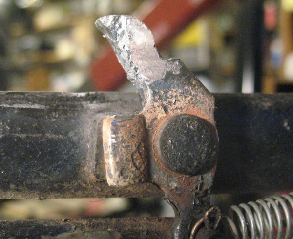

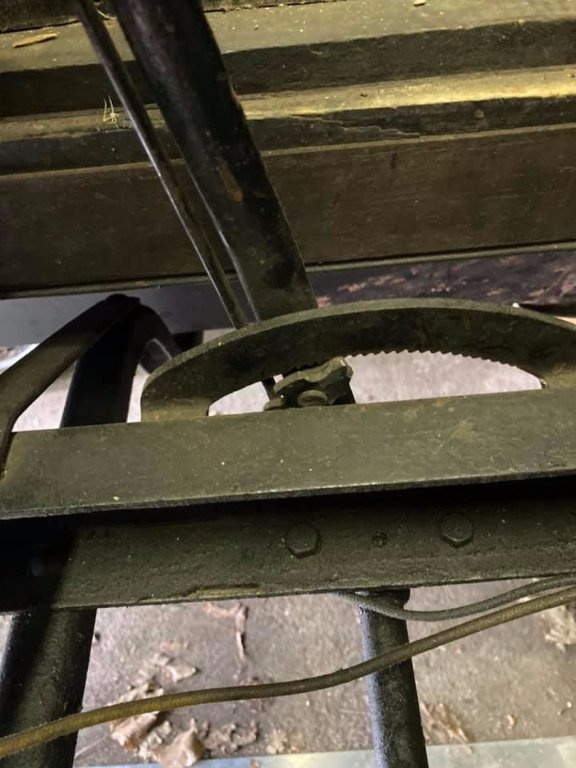

Not sure how to post a picture..Anyway, the floor is out, the rods to the rear axle are intact. The pawl on the lever is not lined up with the teeth on the rack. I also noticed the thin rod from the dash choke knob to the bell crank is missing.

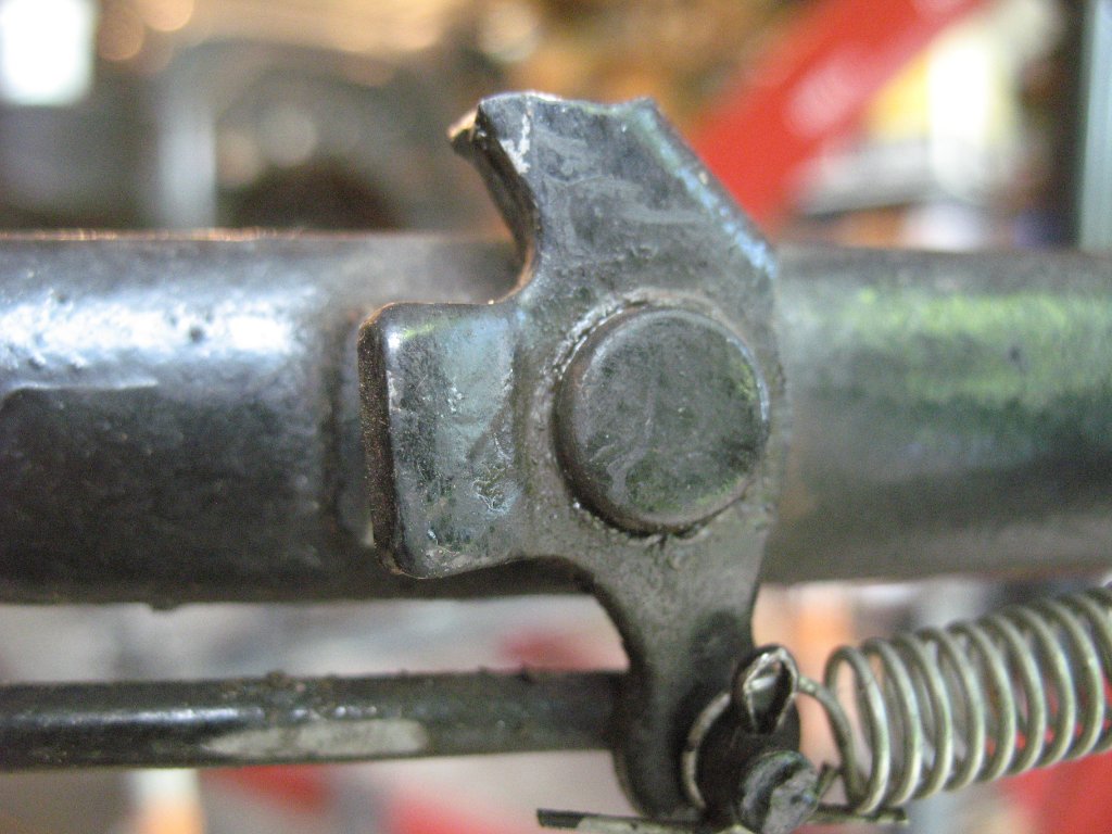

It's hard to tell why the pawl doesn't align with the quadrant, but either something is worn to make the cross shaft shift or the pawl to the right or something is bent. If you can get the pawl to line up with the quadrant, the problem with the lever locking in place should be solved. To get the brake to lock with the lever before the lever hits the seat, would be to tighten up each rod one half turn at a time until you achieve this. Then do two things, One would be to jack up both rear wheels and be sure they can turn freely with the lever in neutral of high gear position. The other thing would be to sure the rods are equally adjusted so that both wheels stop at the same position of the lever. If it pulls to one side, either loosen that side or tighten the other side till they are equal and the wheels are free to spin with the brake off.
- Posts: 4671
Re: Diving in head first
The pawl should be in line with the teeth on the quadrant. Position the pawl where it will go under the the quadrant and try to slide the cross shaft where the pawl will be under the quadrant. Somehow it got moved over. Something has caused it to move over or something is bent.
OR the pin that holds the pawl in place on the hand brake handle is almost pushed out. If it is that’s your issue.

Referring to the picture above, note the oil hole for the controller shaft. Get some oil in there. Also referring to the same photo, it appears the pawl is worn. It should have a sharp point.

You can weld it up and grind a new point.
Taint purty but it works.

A lot of good advice here! Just one more thought, with a handbrake in that condition it's advisable to jack up a rear wheel or at least chock the fronts when hand cranking. Enjoy your " T ", it's a fierce learning curve !

My parking pawl did not line up and the teeth were worn. Though I don't remember what I did to fix the alignment, I must have been able to look at it and figure it out. The teeth I sharpened with a hacksaw blade when it was disassembled from the frame. Put it back together and it holds good. I also bought new springs, one for the handle and one for the tooth lever.

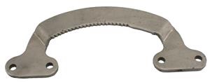

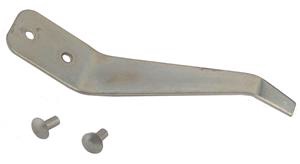

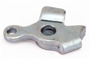

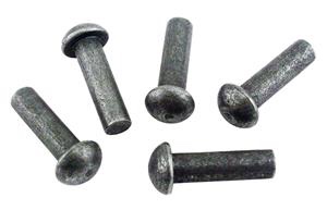

If you decide to replace the handbrake pawl Lang’s has new ones and the step rivet that’s used to secure it. The parking brake assembly isn’t hard to take off and work on. Good luck!

Your handbrake pawl is well worn. It needs to be sharp for correct engagement. Either weld it up and file a new point, or replace it with a new one.
I rebuild them because RHD replacements are not available, especially the early cast ones. To be able to file/hacksaw the teeth on the quadrant, it should be taken off the frame. Otherwise you cannot easily get to all the teeth. I have seen some horrible efforts with these. If you have to take it off, you might as well fit a new one. The laser cut ones are much better, havin full width teeth to engage the pawl.

Any specific tools needed to replace brake lever pawl rivet? I have hammer and small anvil..
- Posts: 5246
Grind off the set side flush with the handle.(opposite pawl) Pin punch & hammer.

Replaced the pawl yesterday and everything went fine. Tried to start the car but only got a couple of momentary firings. The coils buzz quietly...when one is buzzing. Battery shows 6.2v, is that low?

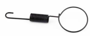

You can go to Snyder’s or Lang’s to find the following new reproduction hand brake parts if you are unable to refurbish the original parts:

I’m going to try and post a picture of the band adjusters
