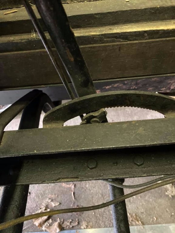

Not sure how to post a picture..Anyway, the floor is out, the rods to the rear axle are intact. The pawl on the lever is not lined up with the teeth on the rack. I also noticed the thin rod from the dash choke knob to the bell crank is missing.

Post by Norman Kling » Mon Jun 21, 2021 9:05 pm
It's hard to tell why the pawl doesn't align with the quadrant, but either something is worn to make the cross shaft shift or the pawl to the right or something is bent. If you can get the pawl to line up with the quadrant, the problem with the lever locking in place should be solved. To get the brake to lock with the lever before the lever hits the seat, would be to tighten up each rod one half turn at a time until you achieve this. Then do two things, One would be to jack up both rear wheels and be sure they can turn freely with the lever in neutral of high gear position. The other thing would be to sure the rods are equally adjusted so that both wheels stop at the same position of the lever. If it pulls to one side, either loosen that side or tighten the other side till they are equal and the wheels are free to spin with the brake off.

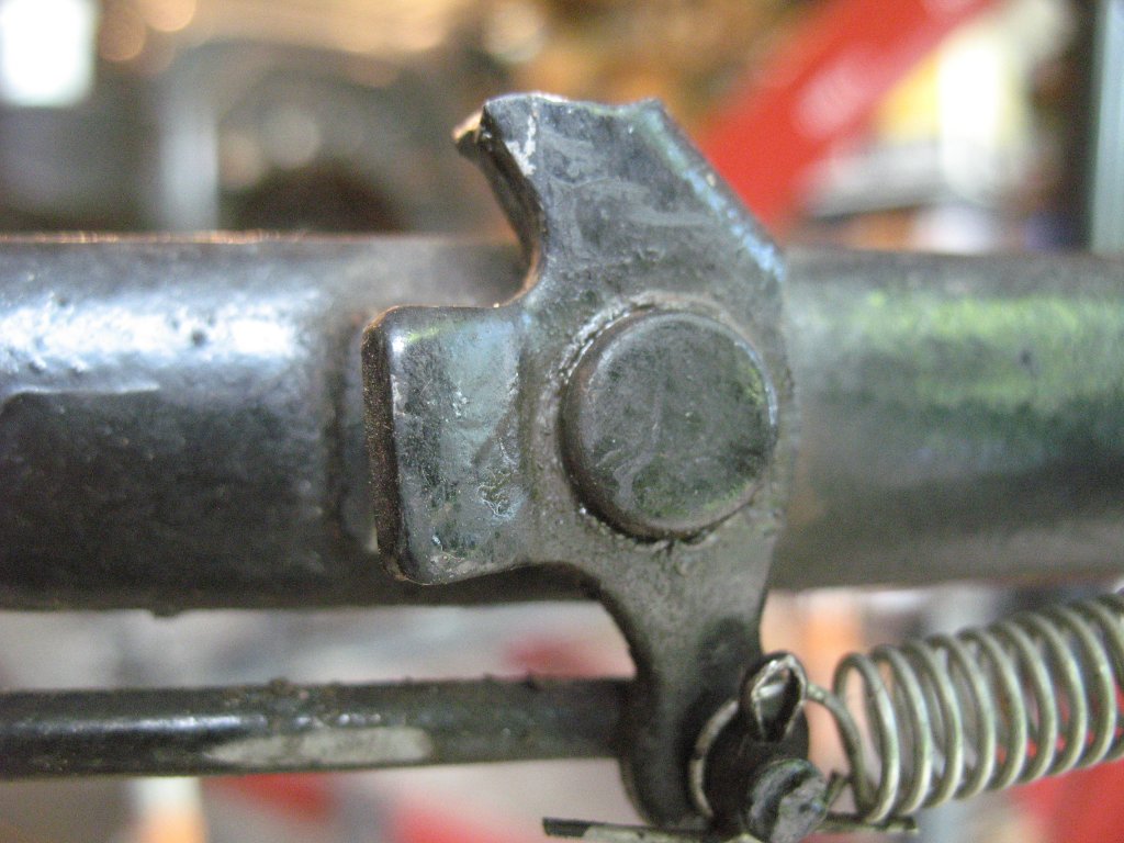

Post by John kuehn » Mon Jun 21, 2021 9:23 pm
The pawl should be in line with the teeth on the quadrant. Position the pawl where it will go under the the quadrant and try to slide the cross shaft where the pawl will be under the quadrant. Somehow it got moved over. Something has caused it to move over or something is bent.
OR the pin that holds the pawl in place on the hand brake handle is almost pushed out. If it is that’s your issue.

Post by Original Smith » Tue Jun 22, 2021 11:18 am
Referring to the picture above, note the oil hole for the controller shaft. Get some oil in there. Also referring to the same photo, it appears the pawl is worn. It should have a sharp point.

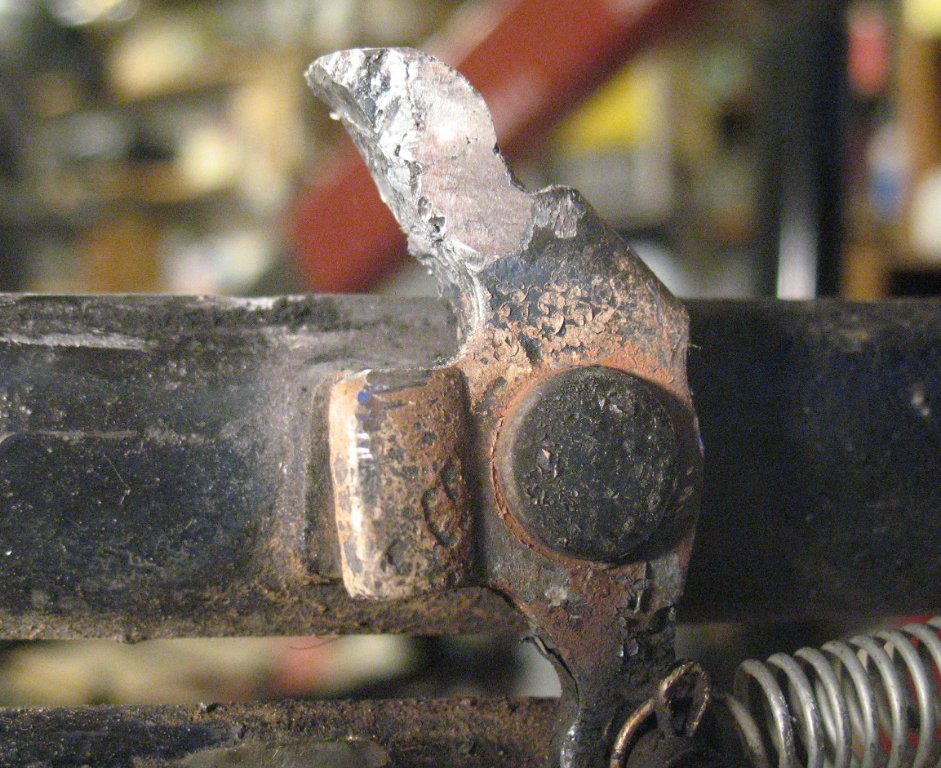

Post by Steve Jelf » Tue Jun 22, 2021 3:26 pm
You can weld it up and grind a new point.
Taint purty but it works.

Post by Allan » Mon Jun 28, 2021 11:32 pm
Your handbrake pawl is well worn. It needs to be sharp for correct engagement. Either weld it up and file a new point, or replace it with a new one.
I rebuild them because RHD replacements are not available, especially the early cast ones. To be able to file/hacksaw the teeth on the quadrant, it should be taken off the frame. Otherwise you cannot easily get to all the teeth. I have seen some horrible efforts with these. If you have to take it off, you might as well fit a new one. The laser cut ones are much better, havin full width teeth to engage the pawl.
Hope this helps.

Any specific tools needed to replace brake lever pawl rivet? I have hammer and small anvil..
Posts: 5253
First Name: john
Last Name: karvaly
Location: orange, ca
Re: Diving in head first
Post by speedytinc » Sat Aug 07, 2021 2:29 pm
Grind off the set side flush with the handle.(opposite pawl) Pin punch & hammer.

Post by Techmaven » Mon Aug 16, 2021 8:56 am
Replaced the pawl yesterday and everything went fine. Tried to start the car but only got a couple of momentary firings. The coils buzz quietly...when one is buzzing. Battery shows 6.2v, is that low?
