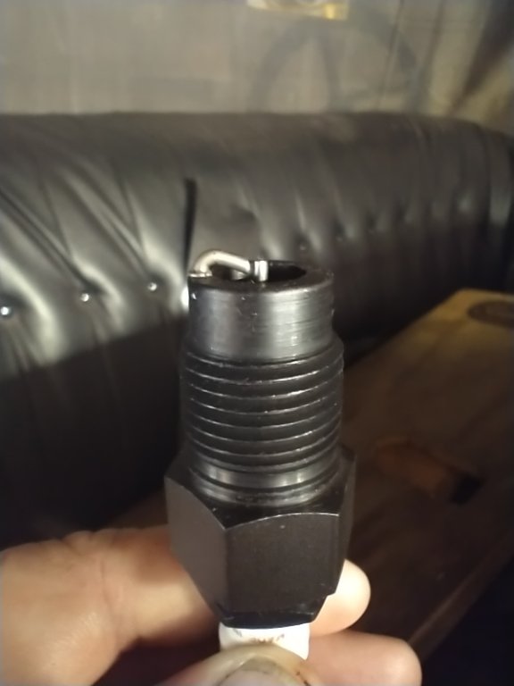

I had a pretty good week last week so I decided to throw a few bucks at some Champion X spark plugs.
They came and they really look great, but right now looking great is all they're doing because I don't know how to gap them.
Or how to measure the gap. Or where to measure the gap. Or how to adjust the gap.
And despite having had a really good week I'd prefer not to damage these plugs by fiddling around with them without knowing what I'm doing.

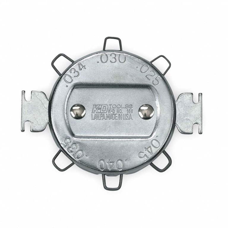

I use one of these tools to gap my plugs, they are commonly available at most auto parts stores. I adjust the gap so that the 0.030 wire just slips through the gap with a light "snap".
Never bend the center electrode. Use the notched arms on the sides of the tool to bend the side electrode as needed to set the gap. :)

Thanks for the explanation. I have the disc type gap gauge but I'll pick up one of the wire ones.
Do I bend the side electrode up to increase the gap?

Frankly, I can't remember which way does what, just use trial and error. The bend will be small, it won't hurt the electrode if you have to bend it a few times to get it right. :)

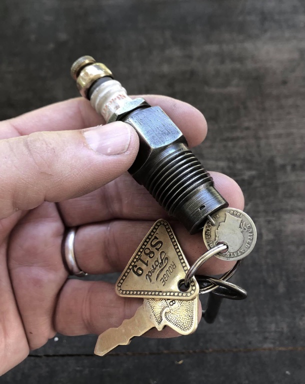

One thin dime.
1924 Touring

I was a little skittish about bending those electrodes. Out of the box they were gapped about .010. I didn't want to do too much bending back and forth, so anything between .025 and .030 I called good. :lol:
While I'm not disappointed, I haven't noticed any better performance over the three dollar Motorcraft's that are now in the drawer. I think.
It IS starting much easier, but I attributed that to a fully charged battery and properly adjusted generator, which I did at the same time.
And after reading one of Scott Conger's posts on another thread I figured out that I was winding it up too much in low gear, like you would a Volkswagen Beetle. Shifting to high at a lower road speed has made the car run exponentially better. At least it seems like it.
So it seems I introduced too many variables to be able to confidently state that the Champion X's are making it run better. It's not running any worse, and it looks a helluva lot better!

A thin dime and an old Champion X

I haven't seen or heard a real dime in over 40 years.
