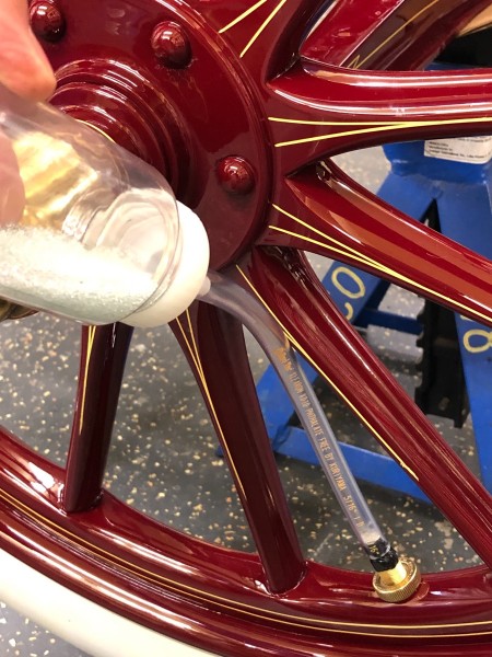

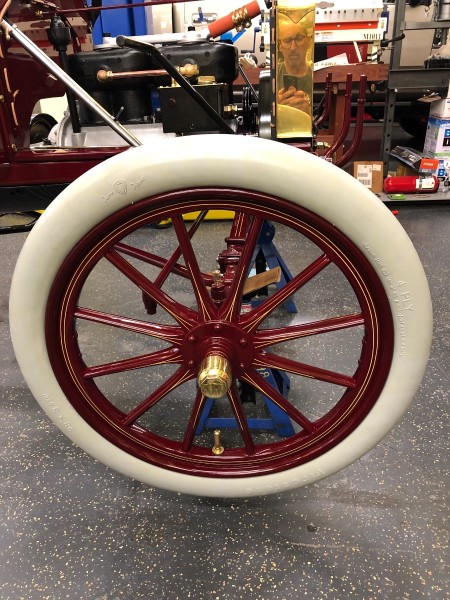

They are great, I have them in every antique car I own. Even if you don’t drive fast you can feel the difference. I just installed them in my Model N and it only took 30 minutes to do all 4 wheels. Generally you must use one of those vibrating engraving tools on the valve stem to keep them from plugging up. You can buy them at Harbor Freight for almost nothing.

Opps, here’s the pics of the install.

Just read a suggestion here on another thread about using a squirt of air pressure when the plastic tube fills up like it's starting to do in the last picture. If you don't have a vibrating engraver, You might have a electric tooth brush like I have used.
Next time I'm going to try the air hose after reading the other post!

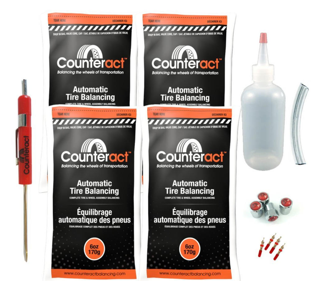

I just installed these in all 4 tires this past weekend. What a pain, but highly worth it.
I used an air chisel wrapping the chisel end w/ a little duct tape and used it with an air pressure reducer set low enough that the chisel vibrated at just the right tempo as it rested against the valve stem to let the glass beads roll through the stem and into the tube. I ended up heating the end of the plastic hose so it fit more fully over the valve stem and didn't pop off (that makes a serious mess).
the vibration in the front end is now gone at 40mph.
I bought this 6 oz x 4 pkg:
https://www.amazon.com/gp/product/B06X1 ... UTF8&psc=1
truth be told, I did forget to put air in the left rear before I took it for a test drive...

Do you have to use the valve covers they send?

Re: balancing beads
I think it best to use the included valve stems which will not get blocked by the beads, and the covers to let anyone who might let air out of the tire that balance beads are in it. You don't want the beads coming out, and you don't want anyone to add something like the green slime to patch a leak.

Valve cores, I agree but them are some hokey looking stem covers to install on a T !
