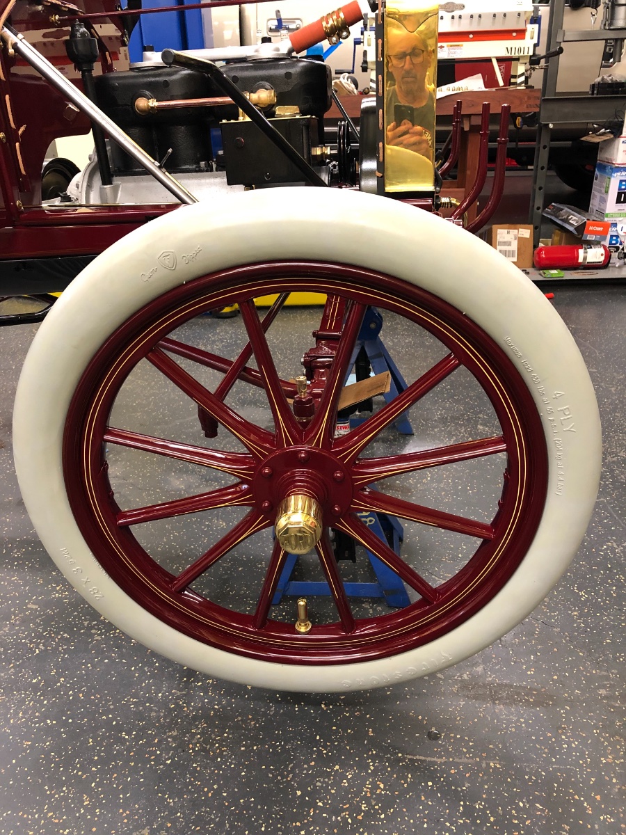

They are great, I have them in every antique car I own. Even if you don’t drive fast you can feel the difference. I just installed them in my Model N and it only took 30 minutes to do all 4 wheels. Generally you must use one of those vibrating engraving tools on the valve stem to keep them from plugging up. You can buy them at Harbor Freight for almost nothing.

Opps, here’s the pics of the install.

Just read a suggestion here on another thread about using a squirt of air pressure when the plastic tube fills up like it's starting to do in the last picture. If you don't have a vibrating engraver, You might have a electric tooth brush like I have used.
Next time I'm going to try the air hose after reading the other post!
