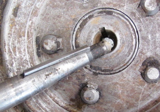

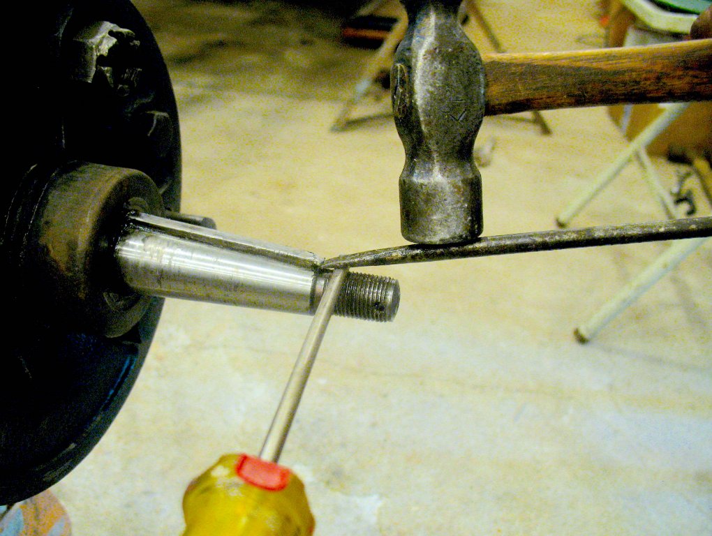

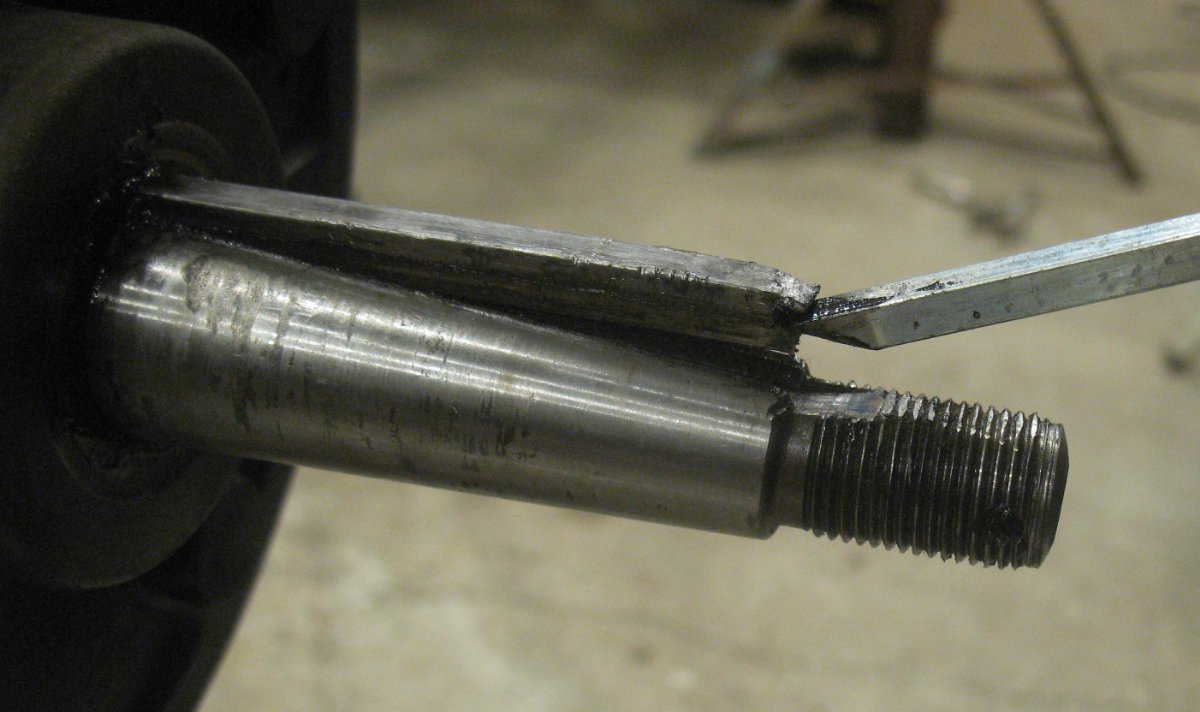

I install with the taper pointing down and towards the bearing...
Me too. But after having to cut a notch in the outer end to pry one out when it was in the slot really tight, I grind a little chamfer on the bottom of the outside end so I can drive a screwdriver under it to get it out.
This didn't work.
A little pry bar made from a piece of key stock finally got it loose.

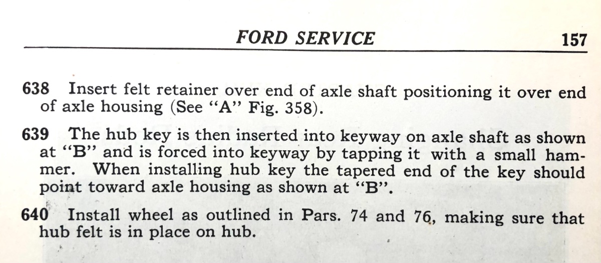

Post by DanTreace » Mon Aug 02, 2021 7:23 pm
RajoRacer wrote:
Sun Aug 01, 2021 12:28 pm
Does anyone else having definitive proof or documentation of the correct installation ?

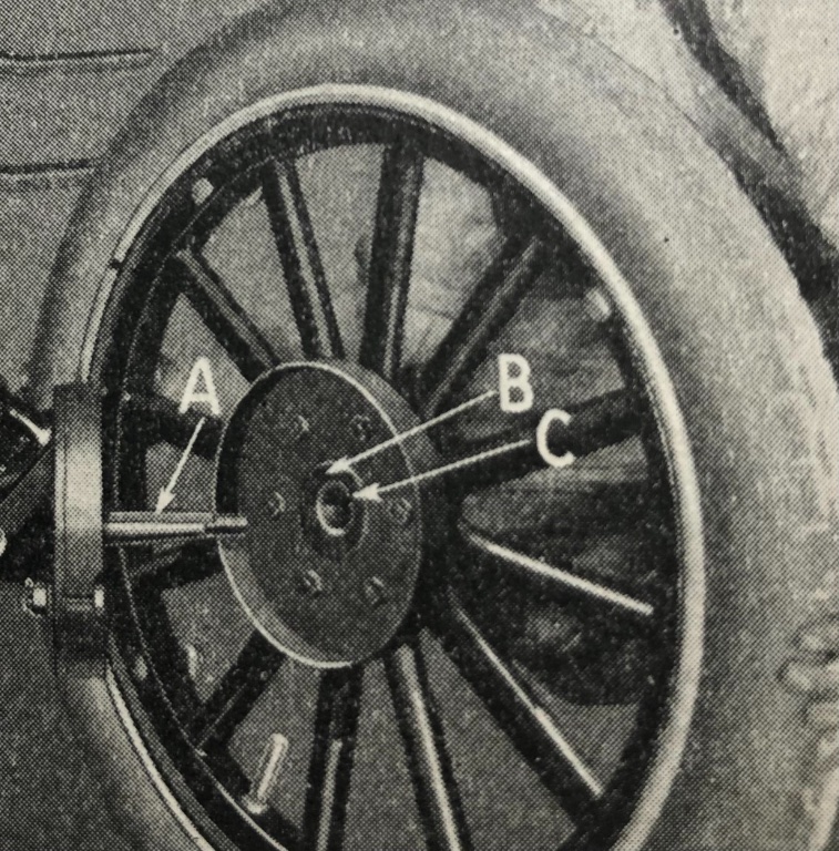

Ford Service , paragraph 639.
Original Ford axle keys, the taper goes down and into the taper end of the axle keyway, toward the rear axle housing.
That way the entire length of the axle key surface is within the hub.
Square end of the axle key enters the hub keyway.

Posts: 5602
Re: Which Way Does the Rear Axle Key Go ???
Post by RajoRacer » Mon Aug 02, 2021 7:24 pm
Thank you Dan - that is quite definitive !
