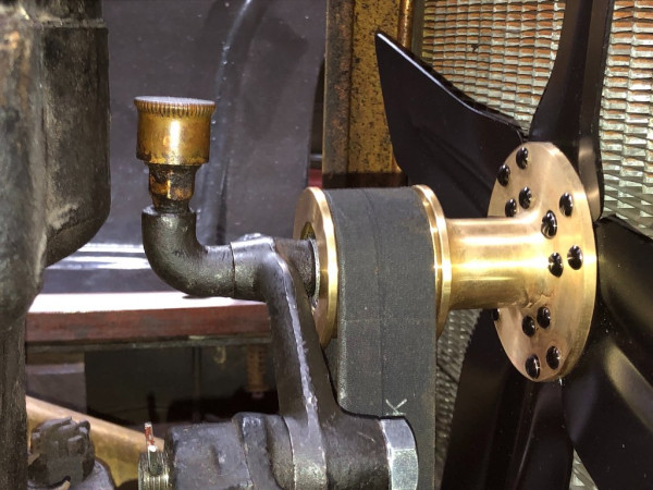

SpeedyT spotted that the grease fitting elbow for the fan on my Frankin T '14 was a clever improvement by a gifted builder and not an original FORD part. It looked so at home and worked so well I assumed that Ford built it that way. Now that the ball bearings in the hub rendered it no more than an ornament I could retain it or go back to original. This car is a mixture of parts so there is no real reason to be original except that it pleases me to return this car to its stock appearance wherever possible so I added a stock dope cup to an order I had with one of the suppliers for another project on the same car.
The part arrived and looked to be well made. It was a bit dull so I polished it so that it would more closely match the fan hub. They can tarnish together & look more at home that way. I grabbed a 1/2" wrench and found it was just a bit too snug to fit the hex on the cup. 9/16 was too large. 13mm fit like a glove and the cup is now installed on the car and looking very proud of itself.
I was not as pleased as the cup was. While truly grateful to have the part available at all, I was a bit peeved to need a metric wrench to install it. The cup threaded onto the shaft as it should, the maker got that SAE thread correct. Why not make the hex an SAE size also? Surely it can't be any cheaper to make it wrong that it would be to make it right?
Then another thought occured to me. I read someplace long ago that in the early days of the industry auto makers made their own threads. Packard for example supposedly had threads on nuts and bolts that no other maker shared. If I remember this correctly, perhaps wrench sizes were the same. This Model T engine dates back to 1908 & was an evolutionary descendent of even earlier engineering. Is it possible that at one time there was a wrench size that fit between a 1/2 & a 9/16?
That certainly seems like a long shot, the repop part is almost certainly just made wrong but I'll bet someone on this list will know the answer.
Paul
Paul

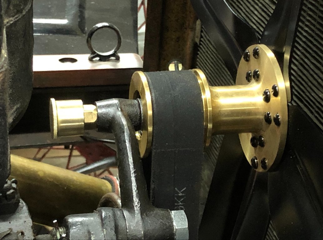

Just a suggestion, why not take a bit off 3 sides and bring it down to 1/2 inch with a file or wheel. A little finishing you (others) may never know it wasn't 1/2 inch to begin with.
Nick
Nick
Mark Chaffin
- Posts: 4847
- Last Name: Chaffin
- Location: Lake Elsinore
Re: 13mm On a Model T - REALLY?
That appears to be our manufactured part. The machined dimension across the flats is 1/2 inch. They are CNC machined. I measured ten samples and they are correct. Compared it to an original and they are identical. When using a 1/2 open end wrench it is a snug fit. Not sure why you are having a problem Paul.
Hudson29
Topic author - Posts: 509
- Joined: Fri Mar 01, 2019 1:51 pm
- First Name: Paul
- Last Name: O'Neil
- * REQUIRED* Type and Year of Model Ts owned: 1914 Touring, 1923 Runabout
- Location: Klamath Falls, OR
Thanks Mark, you had me doubting myself about this so I tried again with the part installed. The 1/2" wrench will NOT slip over the hex. I tried from several angles and found it was the same each time. A 13mm fits it like a glove.
I spread my business around to try to support all of the good suppliers. I want to do my part to keep you, all of you, going so you can support me. This part did not come from you, at least not directly. BTW, David who handles your orders is terrific. He has often helped me puzzle out needs & issues and is a real asset to your business.
Paul

Just to make sure everyone understands, the cup is installed and looks great. Its only functional purpose is to act as a jam nut. I have no issue with using the 13mm wrench. My sole reason for the post was that it seemed odd that a non Ford metric dimension was used on the hex while the Ford used SAE threads were perfect.
Paul

That 17/32 wrench arrived today and just as Scott said, it fits but very loosely. So 13mm it is on this part.
paul
paul
