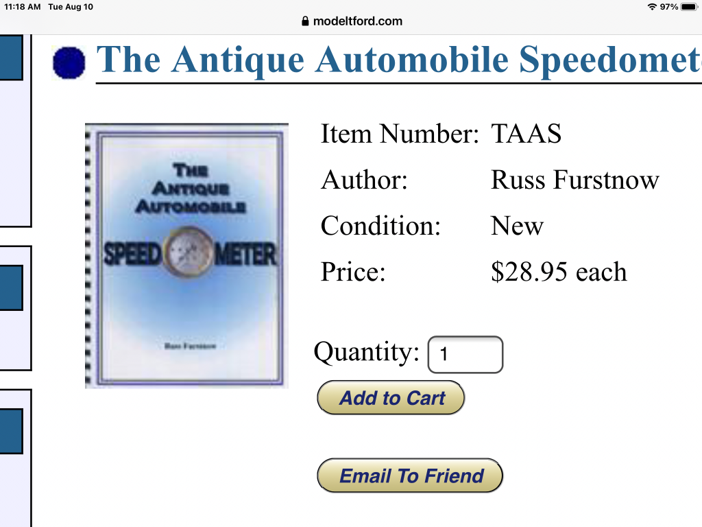

Buy Russ Furstnow's speedometer book. It's a great book, with all the information you will ever need!

The OP has stock photos of model t service books he likes to post upon owners asking questions. . Speedometers are such a very interesting item in model t history, and Russ’s great book explains them extremely well, and is a must-have if any T owners desires a nice speedometer setup, whether stock installs or as an accessory, as some years would be. Original Smith has nailed it. Get the book. I use his book all the time. There is a lot more than just T history, and also much history of the different suppliers. If you are a cheapskate, the small pamphlet printed by the MTFCA would be useful, but not nearly as good as the Big Book. The info that Russ has available is invaluable, and we need to support people who take the time to do so. As always, JMHO
