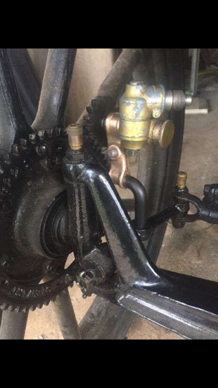

Here is how mine looks on my 14. I bought most of this on eBay and installed it with a Model 100. I then replaced it with a Model C because only the trip odometer on the 100 worked. I like to keep track of my miles. Don’t forget the cotter pin like me or you’ll have to go search for your wheel pinion gear.
