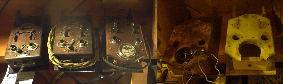

Many of us have this vintage Model T coil tester.
Figure 1. Jefferson Model 28 Combination Tester
Figure 2. Jefferson Model 28 Buzz Box
Its main usefulness to me is a quick and dirty go-no-go tester for checking coils.

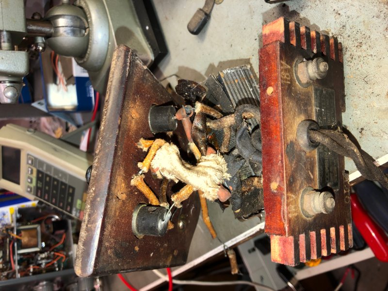

I recently acquired a second one so I decided to “restore” it.
Upon opening it up I found a box of electrical horrors I didn’t quite expect.
The circuits are interconnected with bare and cotton covered wire.
Segments are covered with cotton and rubber sleeving.
After 80+ years, the insulating cotton and rubber are quite deteriorated.
The basic construction method is “bare wire wrapped around a screw”.
Figure 3. Box of Horrors

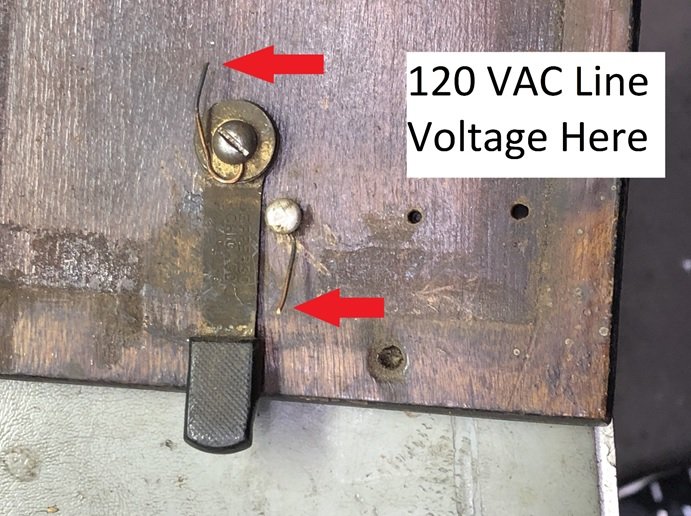

The greatest problem I found was the ON-OFF lever for the 120 VAC power.
The 120 Volt line is connected directly to the lever.
If the plastic tip is broken or otherwise defective the user is exposed to the AC power line (See Fig 4).
Figure 4. AC power line is connected to the ON-OFF lever.

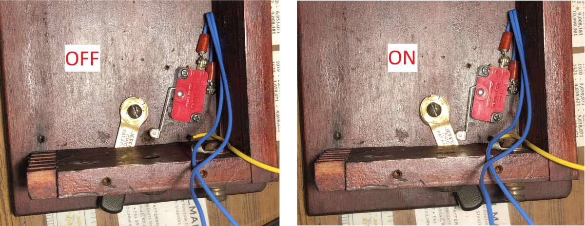

To mitigate this, I installed a microswitch to control the AC power (see Fig 5).
I also replaced power cord and installed a polarized plug.
I reinsulated all of the transformer connections with shrink tube and installed insulated wire.
The AC power is now isolated from the user and the Buzz Box is much safer in that regard.
Figure 5. Safety Microswitch installation.

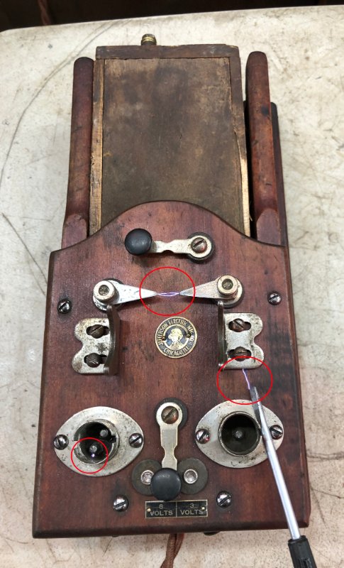

There is a second issue with the high voltage return path.
When a coil is energized an arc will jump the gap at the spark gap pointers.
Because of the way the transformer secondary is tapped and common to the light sockets, the high voltage return path is also through the light sockets (see Fig 6).

Re: Jefferson Electric Model 28 Buzz-Box Coil Tester – Death at your fingertips
Figure 6.Multiple High Voltage Return Paths
