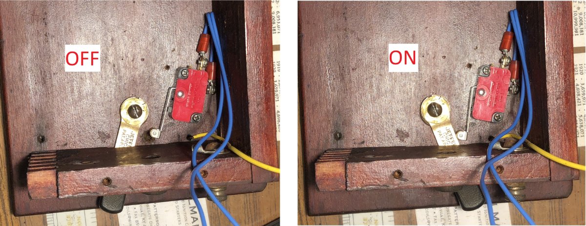

To mitigate this, I installed a microswitch to control the AC power (see Fig 5).
I also replaced power cord and installed a polarized plug.
I reinsulated all of the transformer connections with shrink tube and installed insulated wire.
The AC power is now isolated from the user and the Buzz Box is much safer in that regard.
Figure 5. Safety Microswitch installation.
