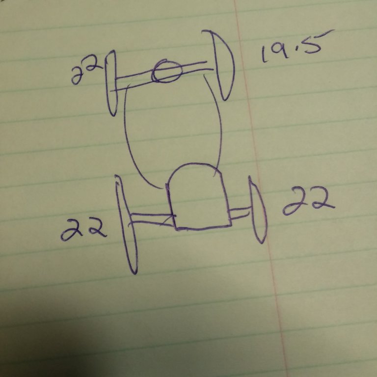

I have three of the same spoke wheels and one odd on my '26 project. [See diagram below]
Three wheels measure approx 22 inches from demountable mounting bolts going from 9 o'clock to 3 o'clock.
One wheel measures approx 19+ inches going from 9 o'clock to 3 o'clock mounting bolt to mounting bolt.
Can someone please educate me on spoked demountable wheels? What am I looking at? Kelsey vs.Ford??
I'm planning on redoing the spokes over the winter,and using most of what i have.
Thanks in advance!

I would hazzard a guess that the odd one is the correct one for an improved car. The other three are for 23" clincher tyres. They may be the correct ones if your car is not fitted with a starter and generator.

My car has starter.
Can I put the smaller brake drum on the bigger wheel? My right rear, as my sketch shows, is a big wheel with a small drum. I don't want to get in to back plate swapping right now.

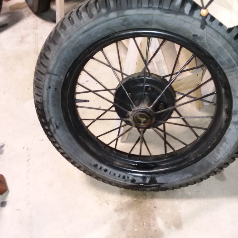

So..... I have three 30x 3 1/2 tires and one mongrel 4 1/2 x21 on the left rear. This left rear wheel has the proper 11 inch brake drum on it though.
I have a 30x3.5 hub, brake drum, spokes, and felloe in my parts stash. Just need a demountable ring to make them all the same.

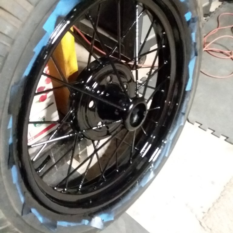

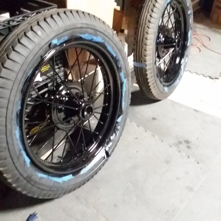

After taking all the info offered, I took the leap after finding a complete 5 wheel set of 26-27 wire wheels in very good shape. Wheels were found 30 miles from home.
My spoke hub and demountable collection will likely be sold as I no.longer need them.
Thank you all for the kind help!
