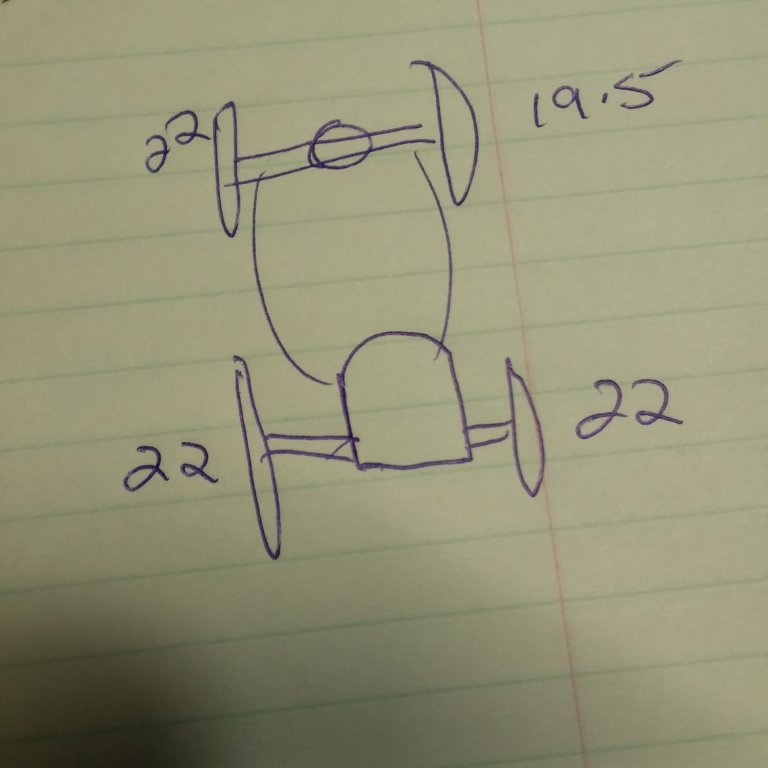

I have three of the same spoke wheels and one odd on my '26 project. [See diagram below]
Three wheels measure approx 22 inches from demountable mounting bolts going from 9 o'clock to 3 o'clock.
One wheel measures approx 19+ inches going from 9 o'clock to 3 o'clock mounting bolt to mounting bolt.
Can someone please educate me on spoked demountable wheels? What am I looking at? Kelsey vs.Ford??
I'm planning on redoing the spokes over the winter,and using most of what i have.
Thanks in advance!

I would hazzard a guess that the odd one is the correct one for an improved car. The other three are for 23" clincher tyres. They may be the correct ones if your car is not fitted with a starter and generator.

If the small tire is correct, then what are the 23 clinchers off of?

The wheels changed from 30 x 3.5" beaded edge tyres like the one shown in your photo as the right front tyre, to 21" wheels in 1926. Your car most likely should have 21" wheels. Check the one you have. If it is a T model rim, it will have a join in the rim near the valve stem, and the tyre will have straight sides just like a modern tyre.
It is not unusual to find parts from different cars being used to keep a T on the road. This may have been the case on your car. There are a couple of things to consider. The 21" wheels usually have an 11" brake drum on the rear, while the 23" ones have a considerably smaller and narrower 8" drum. This means the backing plates on the rear axle housing are different. What do you have? Photos would be a big help.
If your back axle housings have 11" backing plates, then you most likely should have 21" wheels. If it has small backing plates, then the smaller wheel is the odd one. That said, 30 x 3.5" tyres on a 26 model are unusual, and I believe were only ever fitted to budget models with no generator and electric starters fitted.
In Australia there were a few improved 26-7 cars still running 30 x 3.5" wheels, with the large brake drums.
Hope this helps.

My car has starter.
Can I put the smaller brake drum on the bigger wheel? My right rear, as my sketch shows, is a big wheel with a small drum. I don't want to get in to back plate swapping right now.
I'll get a couple of pics this a.m. for you to look at.
Thanks for your help!

So..... I have three 30x 3 1/2 tires and one mongrel 4 1/2 x21 on the left rear. This left rear wheel has the proper 11 inch brake drum on it though.
I have a 30x3.5 hub, brake drum, spokes, and felloe in my parts stash. Just need a demountable ring to make them all the same.
****Thanks for explaining stuff for me

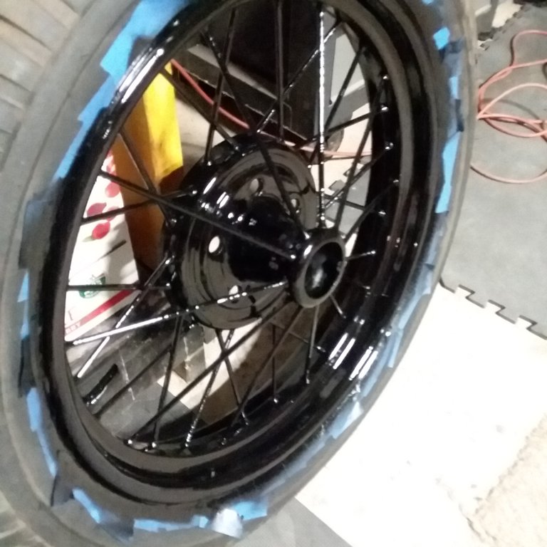

After taking all the info offered, I took the leap after finding a complete 5 wheel set of 26-27 wire wheels in very good shape. Wheels were found 30 miles from home.
My spoke hub and demountable collection will likely be sold as I no.longer need them.
Thank you all for the kind help!
