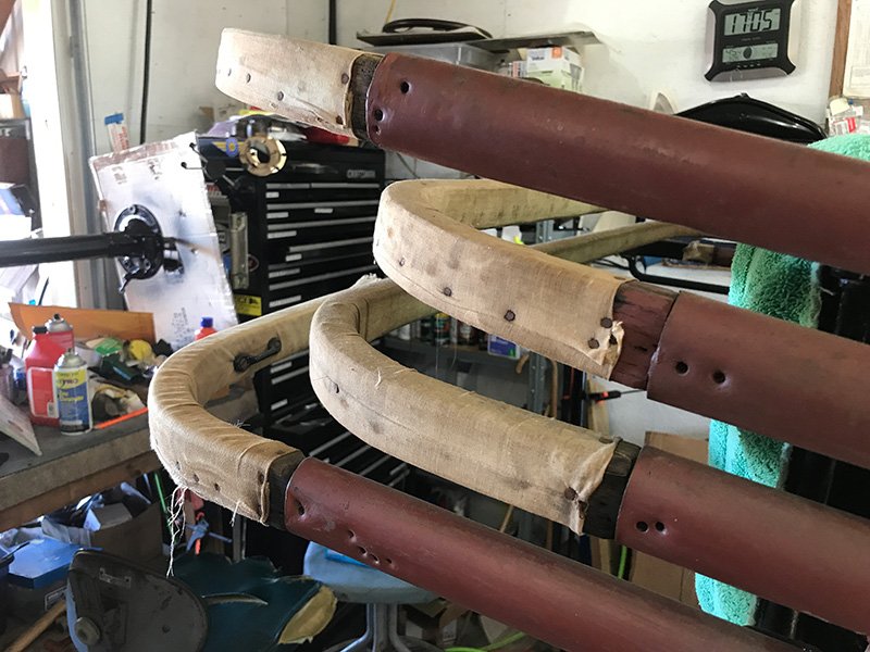

I have yet to try to install a top on my 1917 touring. There are plenty of other things that need to be done first. My question is this... I've been told that the wood portion is normally wrapped in black fabric, but mine are wrapped in white. The fabric looks really old telling me it's been on the car a long time...maybe original.
What is supposed to be used to wrap the bows?

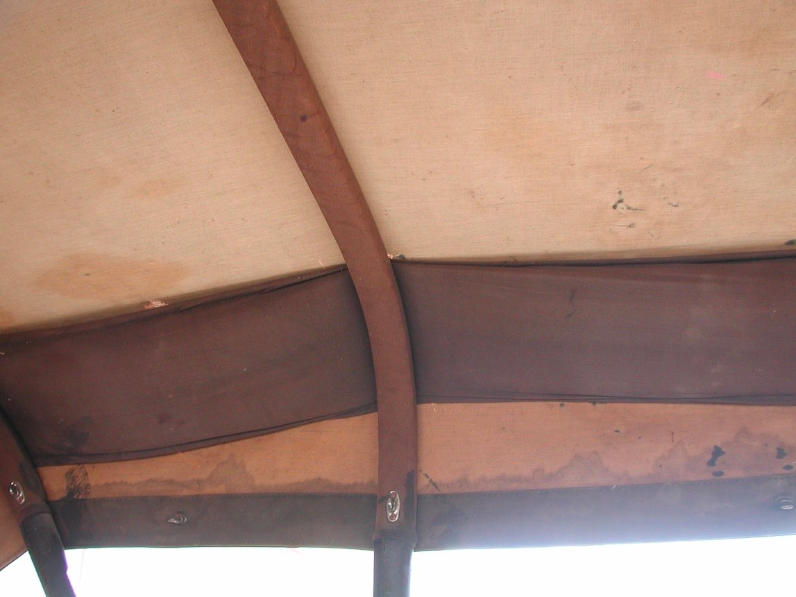

Although the original bow drill and interior side of the top was tan, your cloth does not look original to me. Too light and too much puckering.
Today, most folks use black bow drill.
The first/front bow is wrapped in leatherette. The leatherette is cut on the bias to eliminate puckering.
The next three bows are covered with bow drill which is cloth cut on the bias so it does not pucker.
The cloth for the second and third bows is sewn and not tacked to the tops of of the bows. Tacks will wear through the top material.
Photo below is from an unrestored, almost zero mileage June 1917 touring, AKA "the Rip Van Winkle" Ford.

Totally agree with everything Erik states. Will add the the bow drill material should extend onto the bow socket just enough to almost meet the edge of the top. The ends of the bow drill are then turned under to create a nice, finished and even end. Kind of like a hem.

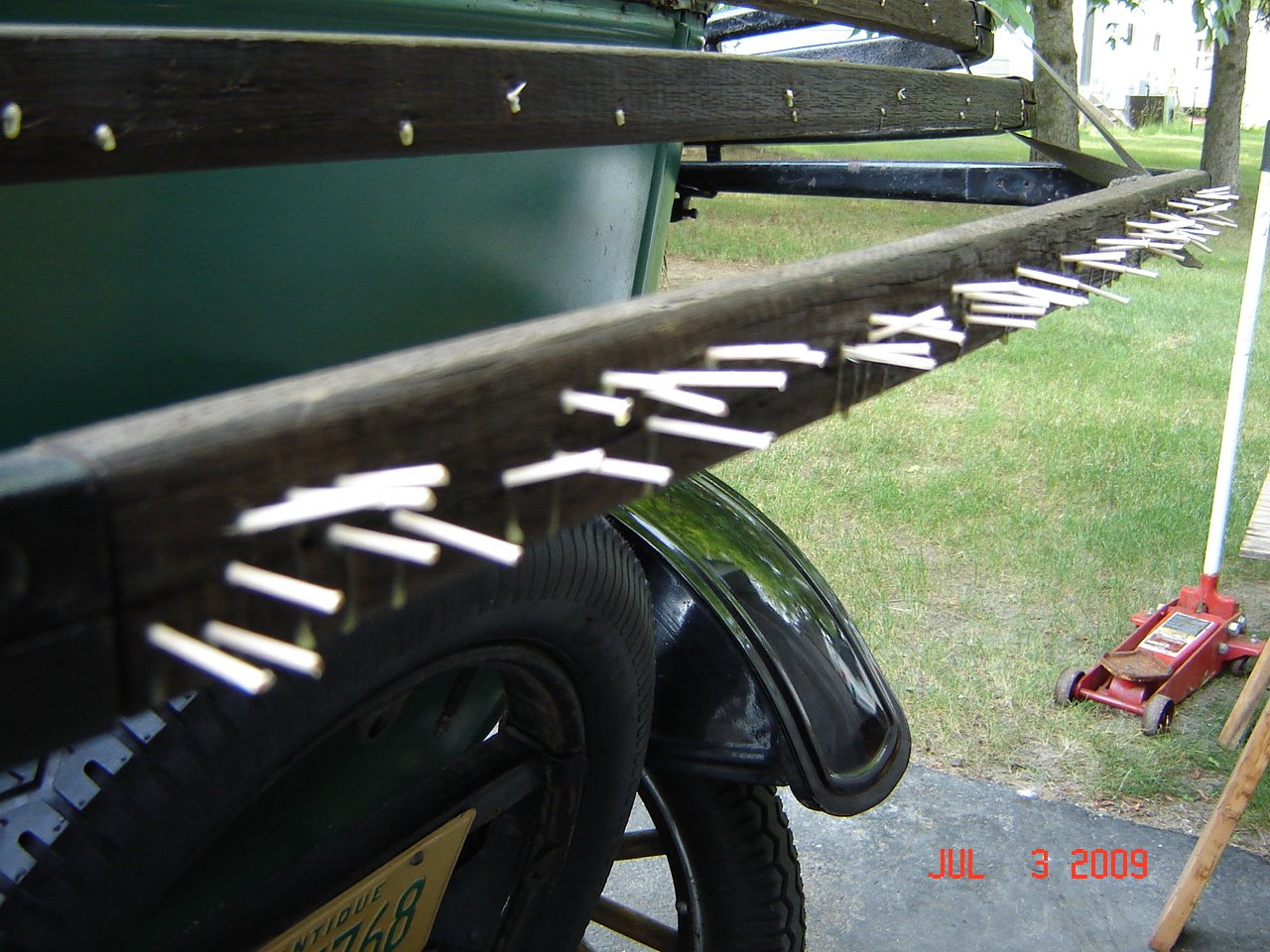

If your bows are just full of holes from the tacks used on previous tops you can fix that. Get a box of round toothpicks and cut them in half with a wire cutter. Dip them in wood glue and tap them into the holes. After the glue dries nip them off close to the bow. Now sand everything smooth with a belt sander.
