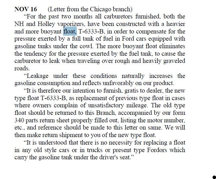

Carburetors in Improved Fords typically came with larger, more buoyant floats because of the increased head pressure available in those cars. Carbs rarely are rebuilt with that correct float. It helps quite a bit.
Do NOT lower the level of fuel in the bowl as that will completely screw up the mixture control. NH's are extremely simple carbs but rely on this one setting to be correct. Your car is running off of the idle circuit up to about 20 MPH before pressure differential is sufficiently high for the main jet to take over. Both require the fuel level to be perfect in order to operate at low RPM and high RPM on the same richness setting. Those folks who either love to play with or MUST play with their mixture control while driving simply have maladjusted carbs.

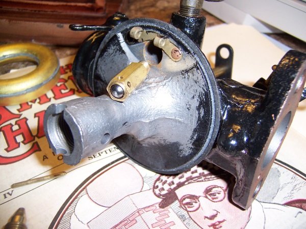

I have the gross valve like what is shown in the picture. Going back to standard needle valve with Viton tip. Thanks for all the responses.

Why do the vendors continue to sell these ball valve/gross jet. They are useless in a gravity system.

Remember, the viaton as purchased wont flow as much fuel as the originals. You could experience leanness @ highest demand (hill climbing) unless modified. Unmodified they still seem to flow more fuel than the gross.radiatorman wrote: ↑Mon Oct 04, 2021 2:20 pmI have the gross valve like what is shown in the picture. Going back to standard needle valve with Viton tip. Thanks for all the responses.

There actually is a Viton-tipped valve which has the correct through-put. It was featured by Dan Treace in the latest issue of the MTFCA magazine.
