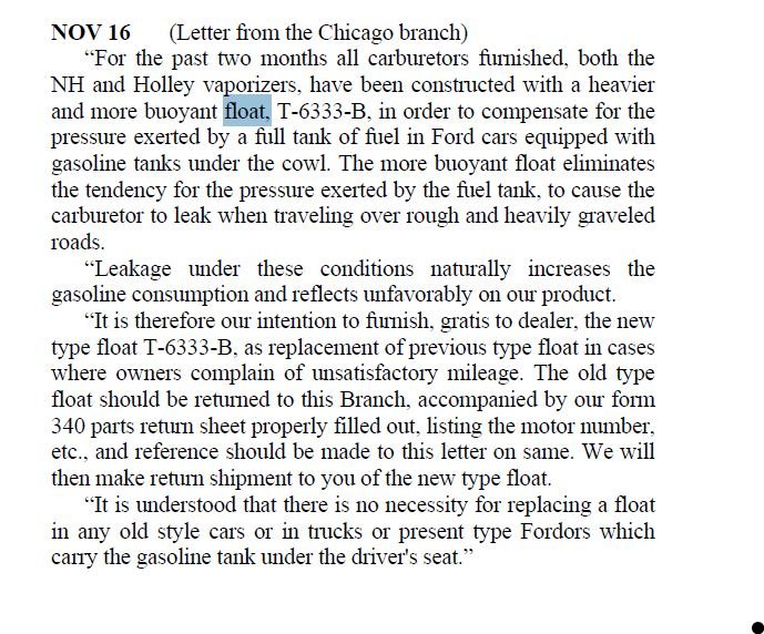

Carburetors in Improved Fords typically came with larger, more buoyant floats because of the increased head pressure available in those cars. Carbs rarely are rebuilt with that correct float. It helps quite a bit.
Do NOT lower the level of fuel in the bowl as that will completely screw up the mixture control. NH's are extremely simple carbs but rely on this one setting to be correct. Your car is running off of the idle circuit up to about 20 MPH before pressure differential is sufficiently high for the main jet to take over. Both require the fuel level to be perfect in order to operate at low RPM and high RPM on the same richness setting. Those folks who either love to play with or MUST play with their mixture control while driving simply have maladjusted carbs.
