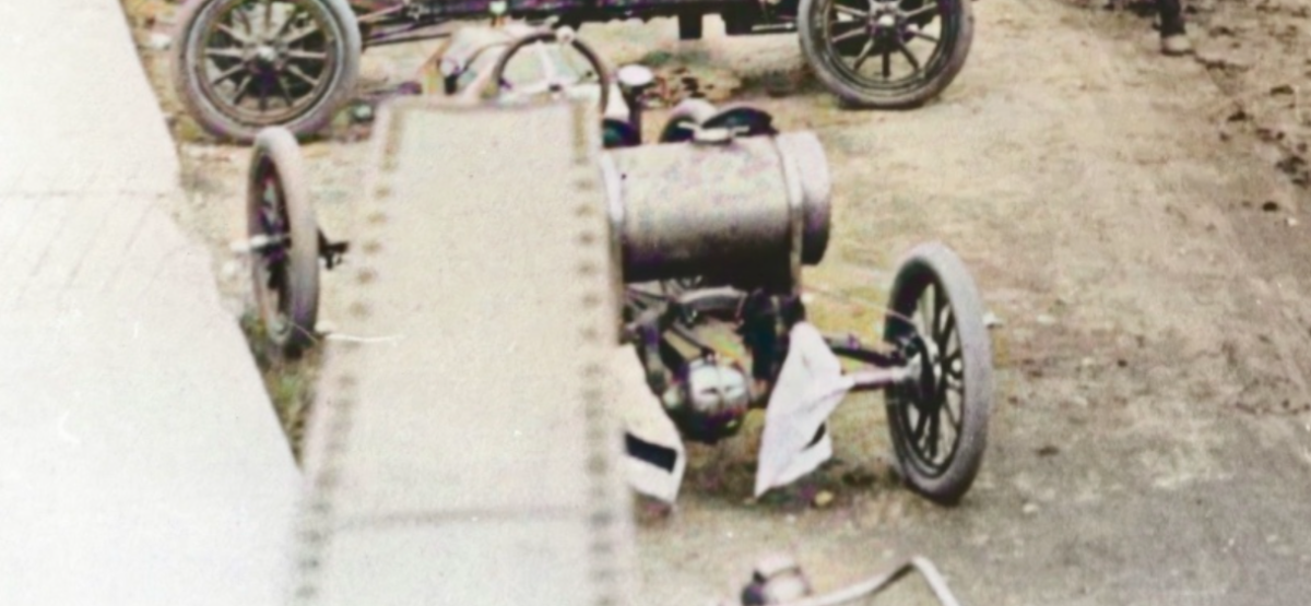

I wish I knew what ratio Ford used when they ran the big racer 109 mph. I know when it beat the Blitzen Benz (fastest car in the world at the time, including 1 mile circular track record) in the one mile timed race the Ford averaged 72 mph from a standing start.
At Algonquin hill climb in 1912 the big racer had 2:1 gears and averaged 65 mph from a flying start. Below is what the pumpkin looked like on the big racer in 1911, when it had 1.5:1 gears:

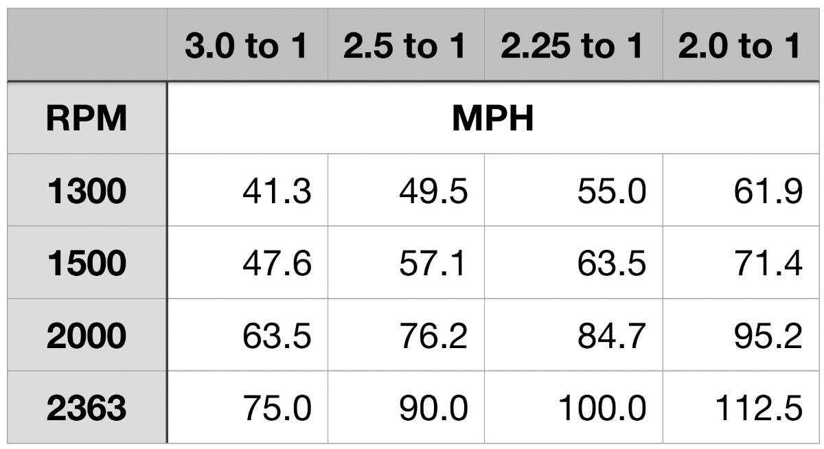

Comparison of 3, 2.5, 2.25 and 2.0 ratio to rpm comparison. I used the top end of 2363 rpm just because that's what it would take to reach 100 mph with a 2.25:1 diff:
