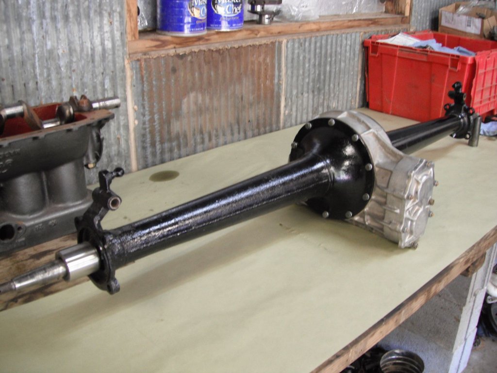

Hey Rob, crazy idea maybe, but for experimentation purposes you could fit a Model A Banjo rear with a Halibrand Quick-change....
It would make finding the right ratio for the Special a lot easier, and when the right ratio is found the Halibrand will be a quick sell.
It would require some 'light' fabrication to fit the rear spring and the torque tube, but hey, that's whats part of the fun right??
Leo van Stirum, Netherlands

The A Banjo/Halibrand combo is not meant as a permanent instalation, just to experiment with ratios, once ratios are worked out just replace with your Special's own rear end (with appropriate ratio Crown and Pinion fitted) and sell the Hallibrand to the first Hotrodder to bid good money for it 8-)
