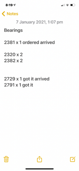

Post by Tracer » Sun Oct 17, 2021 5:23 am
This worked for me but some you will need to find a metric equivalent

Post by dang.1922 » Sun Oct 17, 2021 7:37 am
Thank You Dan and Tracer, I will cross those numbers to metric. Tim, I sent you an email about the transmission strap.---Dan
