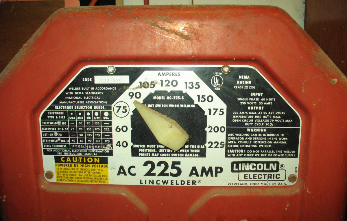

Steve you’ll need a DC WELDER. NOT AC.

I posted this technique on this forum many years ago. I have been using my DC welder to recharge magnets for about 20 years now with no problems. My welder puts out 50VDC and I just set it to the maximum amps it will flow.
Be sure to just flash the connection. Charging only happens in the micro second you make the connection and that instant when you break the connection. The time during the connection does nothing but create detrimental heat!
You only need to flash it once, but sinceI have bothered to set it up I flash several times and then rotate one magnet. I often repeat this through one complete crankshaft turn.
Way overkill, one flash is all you need to charge your magnets (or to demagnetize them if you screw up!).
A charge like this lasts many years… in Rusty’s case it lasts until the ignition switch breaks and shorts mag to bat! With this charging method I can end up starting the car with a 1/4 turn pull of the crank with my left hand (just how Henry Ford and Steve Jelf recommended) on mag!
TH
TH

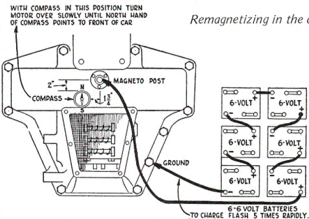

Yes, you are correct. I use a compass which will indicate every other pole.
There are two things wrong with this method as posted:
1) the measurements indicate the center axle of the compass, not the compass card
2) once the flywheel position is set remove the compass before every charging flash. If your method will re-magnetize all the magnets in one flash, what will it do to your compass?
I like to paint a dot on my hogshead. Then I always place the compass on that dot when setting for charging. If you charge once every ten years the dot isn’t needed, but because I turn it to each magnet (alternate poles as each coil charges two magnets and each magnet is charged by two coils) I zap about 8 times around. So I reset the compass each time. Exact placement over my dot gives me an identical compass deflection for each magnet.
I have never gotten a different deflection (decrease in deflection not a reversal) on a magnet as I rotated the flywheel, but if I did I would suspect a cracked magnet. If you spot a cracked magnet you MUST remove the engine and rebuild the flywheel! This is a safety issue!
Remember, one flash and you are done if you want to keep things simple!
TH

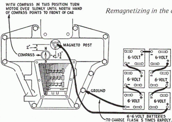

Last time this topic came up someone posted Tom Carnegie’s instructions on using a welder. They are simple and effective. I used my Tig welder set on stick. Start to finish didn’t take 15 minutes.
Easy to find in search.
Andy
Andy

Like the Cicadas, but with 6 year hibernation, this topic re-emerged here in 2021 with many of the same questions and answers from some of the same people as before. The 2015 emergence of the topic was pretty good, here it is, http://www.mtfca.com/discus/messages/506218/528397.html

That compass position is wrong in the diagram above, as there is no reference to the size of that compass case, which will make a lot of difference in your charge effect.
The arrow should be pointing to the pin the compass needle rides on and not to the edge of the case.
Get a Mag Coil Ring and measure the distance between the center of the Mag Terminal and the pole pickup.
Then you can see what I am saying.

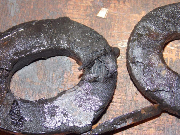

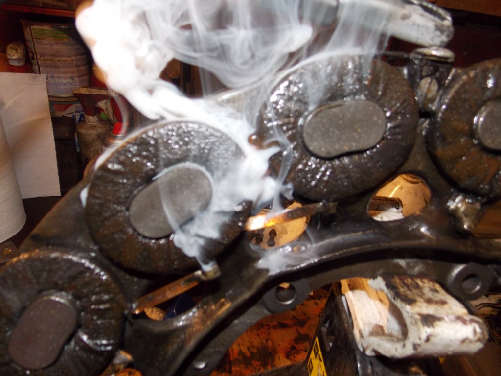

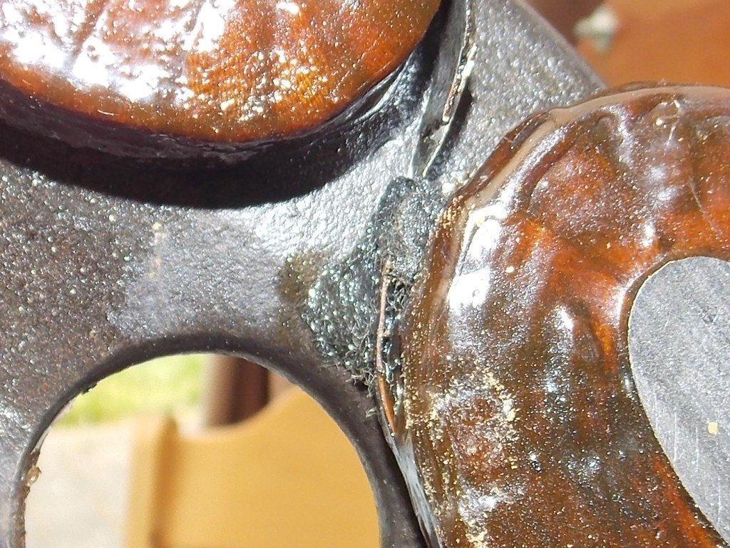

I folowed this thread and just want to add this:
The recharging of the magnets by using the magneto coilring is working whatever you use as power suply but it need to be DC and over 18Vdc.
The second experience I have with this methode is that it is a good control of the shape of your coilring. If you get smoke while trying to do the recharge, your coil ring needs a rebuild. Have seen this a few times.
Both of the loops, in the photos, are out of the engine. They were smoking during a try to get the magneto back alive.
By each engine rebuild I make I also rebuild the coilring. Outside it is maybe looking good but what is going on inside you only can see as you take it apart.
Andre
Belgium
Andre
Belgium

Ity might be a good idea to test the resistance of a coil ring before attempting an in car recharge. Some weak magnetos have one or more grounded coils, which reduces the total resistance of the series coil circuit significantly and might cause the remaining functional coils to heat up much quicker, beside leaving some magnets out of the recharge process.

Maybe the fact that only a quick strike is used to produce the electromagnetic field needed.
Leaving the power any longer creates a heater element & melts stuff. A quick flash on a bare field coil that shows smoke, indicates a short.(bad field coil)

Doing a little Google search, I find that I once posted the Fahnestock illustrations.
http://www.mtfca.com/discus/messages/82 ... 1522763581
- Posts: 5139
Re: In-car magnet charge with a welder?
I re-read Toms excellent post with his exhaustive testing(s). Well worth a COMPLETE read.jab35 wrote: ↑Fri Oct 15, 2021 10:27 amLike the Cicadas, but with 6 year hibernation, this topic re-emerged here in 2021 with many of the same questions and answers from some of the same people as before. The 2015 emergence of the topic was pretty good, here it is, http://www.mtfca.com/discus/messages/506218/528397.html
It narrows the process to it optimal outcome & Minimal effort. I have successfully used his method.
No debate left on the subject in my mind.

This has been discussed many times before and I always recommend guys to search Tom Carnegie's post. He has done extensive research and won the Montana 500 many times. The magnet polarity can be reversed without any care. He posted a very detailed description how easy and successful this can be done in the car without a compass or other means. Welder is best source for in car recharging.

Johnny, Ya got that Right, Tom's method should be in every Ford Repair book! The cool thing is it's the most simple and easiest and yet gets the best results!!
