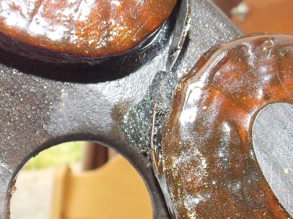

I folowed this thread and just want to add this:
The recharging of the magnets by using the magneto coilring is working whatever you use as power suply but it need to be DC and over 18Vdc.
The second experience I have with this methode is that it is a good control of the shape of your coilring. If you get smoke while trying to do the recharge, your coil ring needs a rebuild. Have seen this a few times.
Both of the loops, in the photos, are out of the engine. They were smoking during a try to get the magneto back alive.
By each engine rebuild I make I also rebuild the coilring. Outside it is maybe looking good but what is going on inside you only can see as you take it apart.

- Posts: 7924
Re: In-car magnet charge with a welder?
Ity might be a good idea to test the resistance of a coil ring before attempting an in car recharge. Some weak magnetos have one or more grounded coils, which reduces the total resistance of the series coil circuit significantly and might cause the remaining functional coils to heat up much quicker, beside leaving some magnets out of the recharge process.
