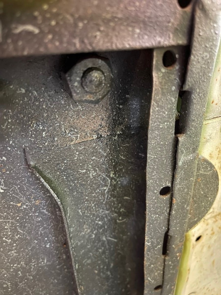

So I'm trying to fit some wood in place and I see that I have to take off the big nut and top Iron support stud.
This is the nut.
Is there a way to hold this stud without having to use vice grips? I don't want to chew it all up.
This is the nut.

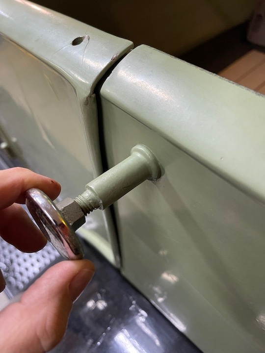

Double nut it, perhaps with thin jam nuts, and that will act as a head on a bolt and things can be taken apart

Remove the cap then do a double nut on the threads. Give you something to hang on to.

OK now I feel dumb. Thanks!!!!!!

Well that worked. I used two nuts and it came right out. Then I showed my daughter that mechanical trickery.
