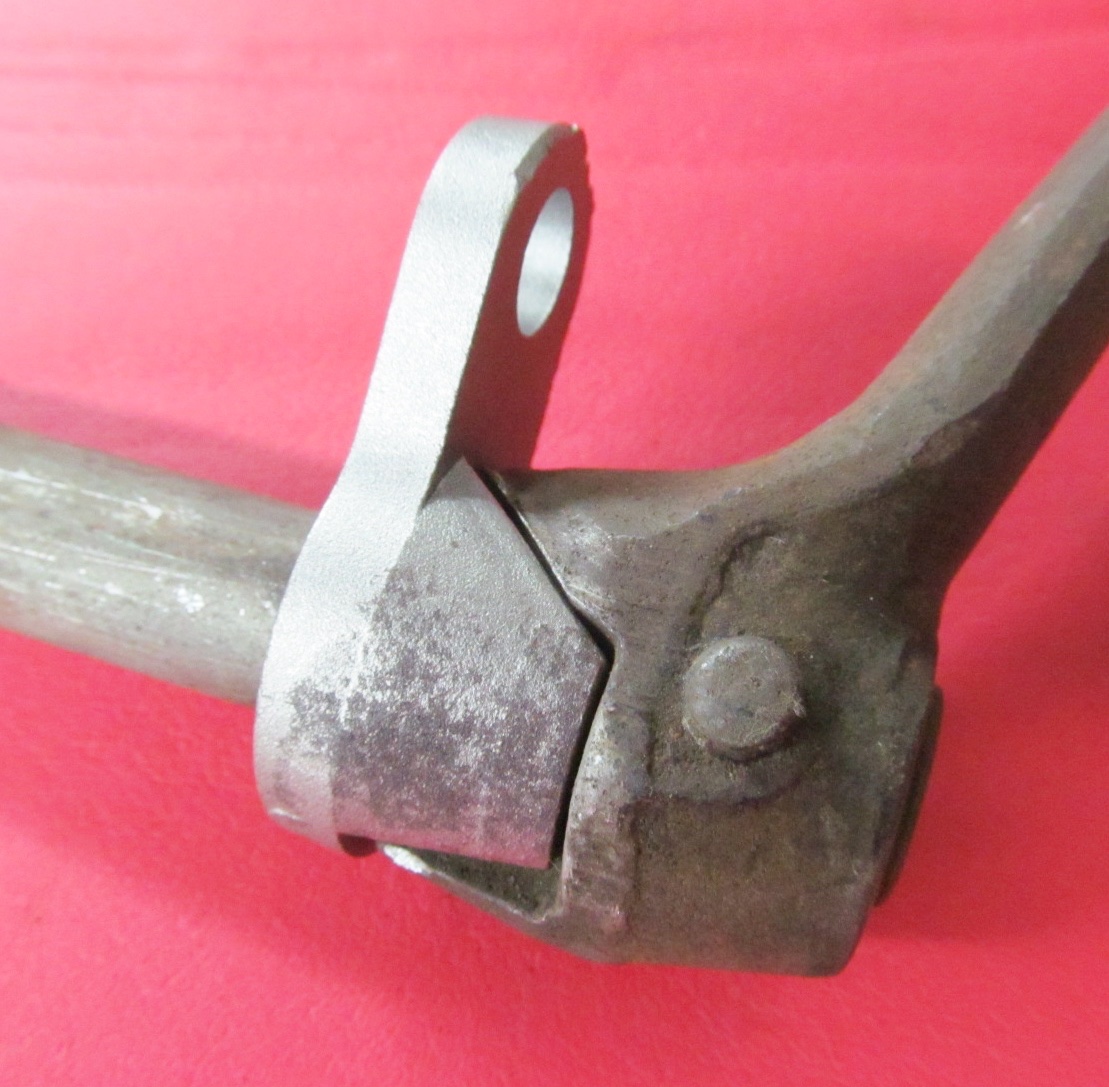

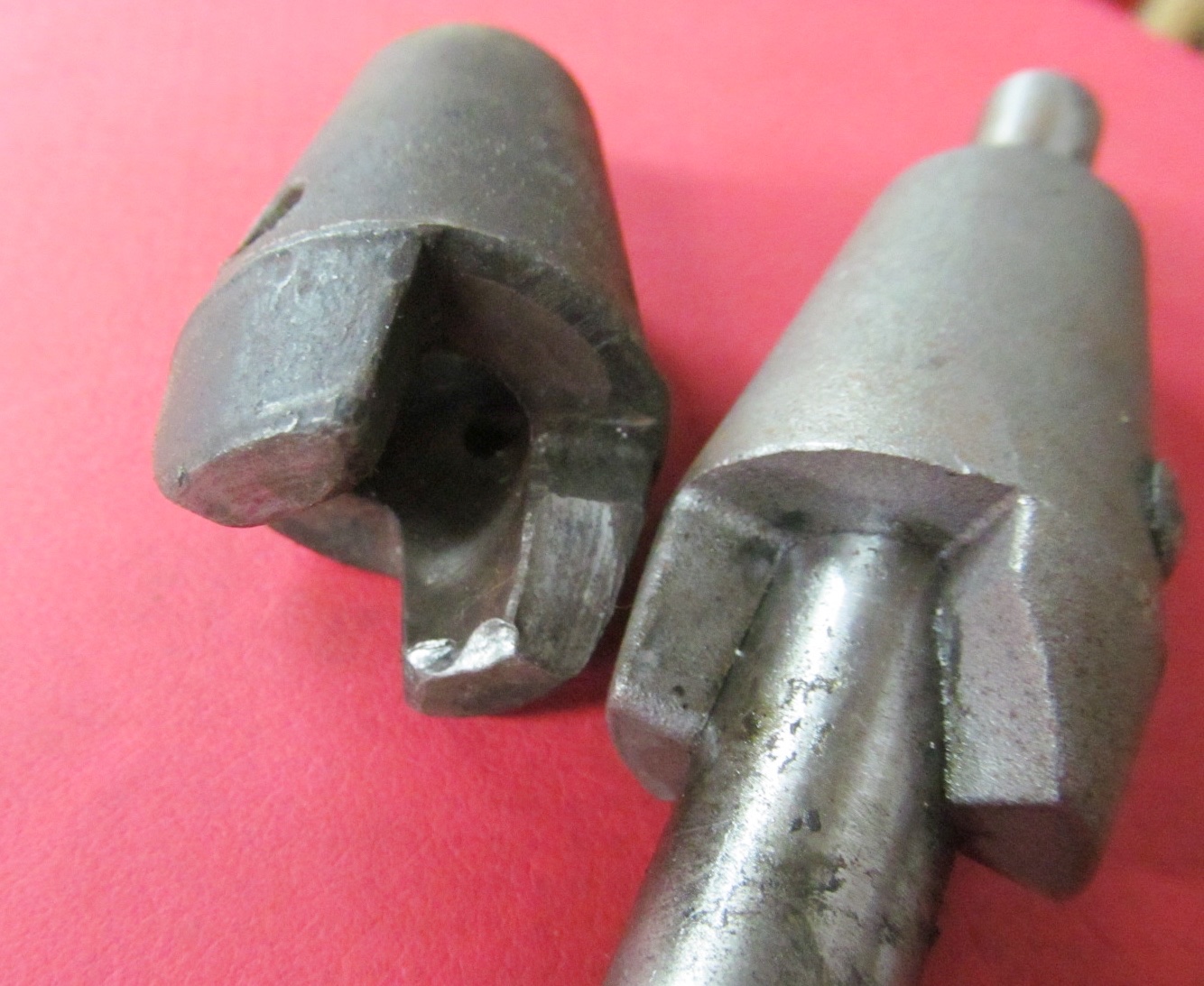

IMO the reproduction pedal cams are just fine, sure beat old used worn cams, now if you CAN find NOS pedal cams...great
But don't hold your breath!
What works good is a pedal in good shape when coupled to a repro pedal cam, action is restored about the best you can do.

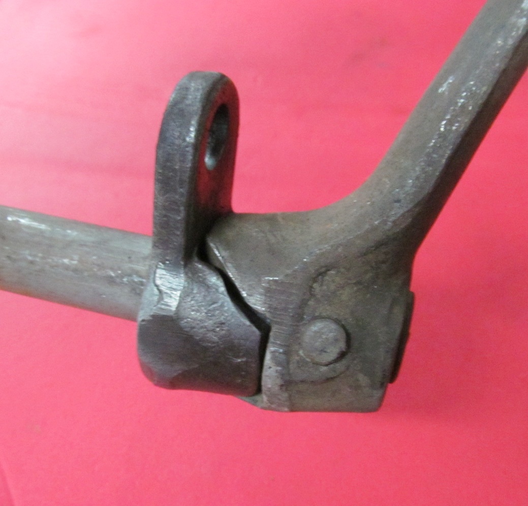

Worn cam compared to reproduction.
Worn cam on a original pedal as removed.
Reproduction cam on same pedal, good fit and function.
