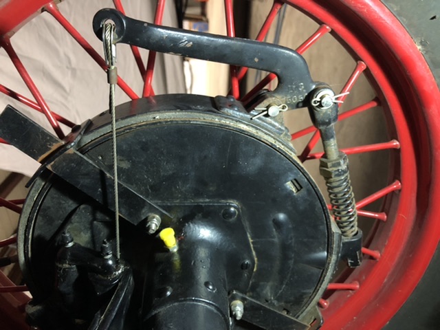

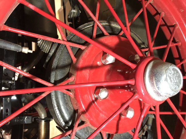

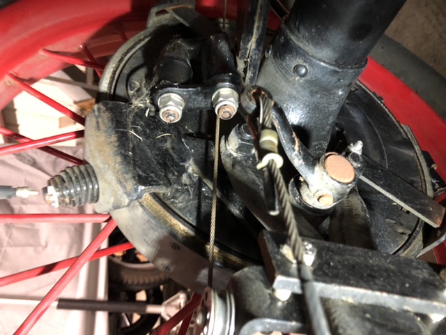

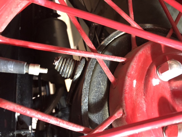

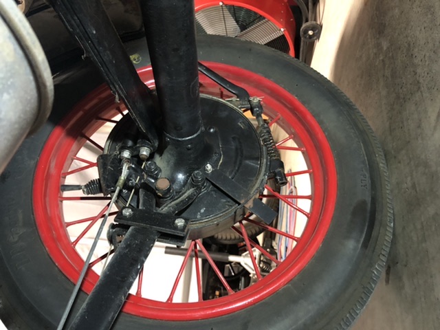

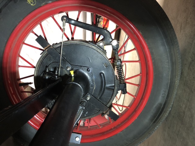

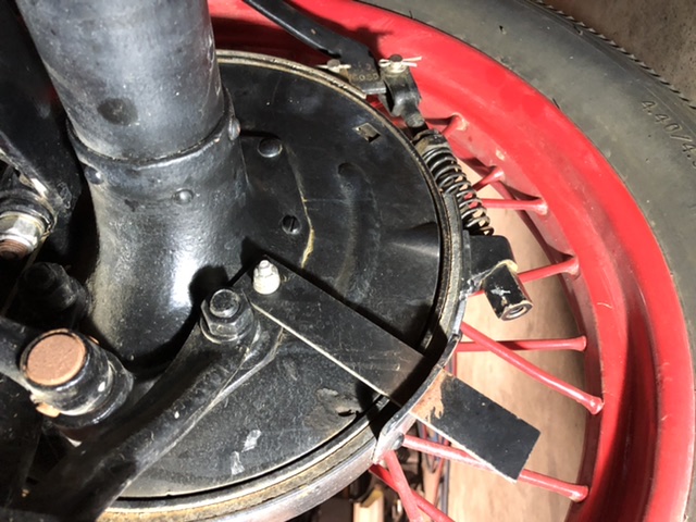

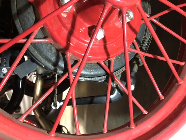

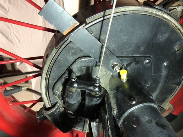

I’ve looked on line for manuals but these do not match current pictures of the Rocky Mountain or A-C. This T was rebuilt 20 years ago. Could they possibly be a earlier version of the Rocky Mountains? Once they are I.D.’d I can hopefully find a manual and parts list.
I apologize for the sideways pictures and have no idea why they turn 90 degrees from the image site to here.

Look like modern Rocky Mountain/AC installed wrong or different than norm without the front mounting bracket. Can't quite see what is going on in the radius rod areas, between it and wheel.

I will take some closer pictures today but from looking at current ads for both brands these are not similar at all and have many different parts.

Agree with your assessment. Band & lining look like current RM modified, possibly with other period parts additionally modified. manufactured, modified & installed by humble hands of home.
First glance, design wise, look ok. Might even work in reverse.

Someone welded on that bracket to the backing plate casting and added a pin to the center of the band, something I have thought of. The lever is simply turned around, as are the brake bands. That added pin to the top, which is missing from the RM setup, could be part of the reason why they don't work in reverse as they should. I have given thought on how to add the anchor pin. That setup look like a way to do it.
