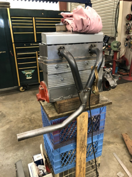

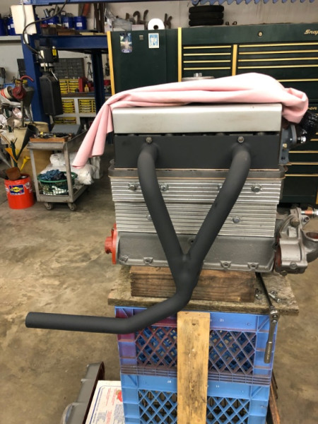

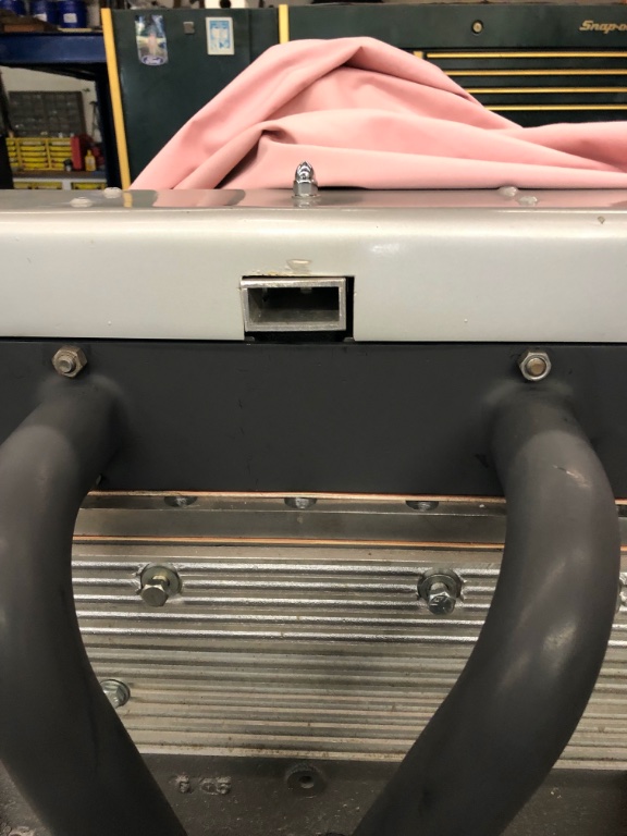

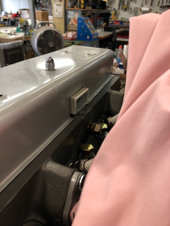

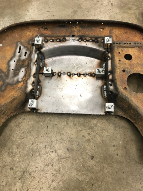

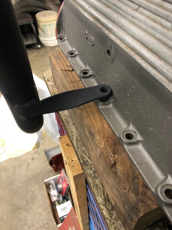

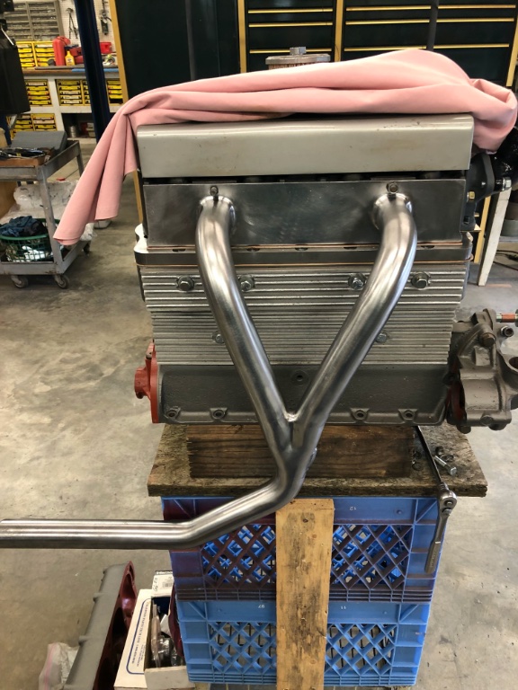

More to add. Heavy support at the Y pipe to prevent metal fatigue.
Spark plug wire cross over duct when using an outside Magneto or distributor.

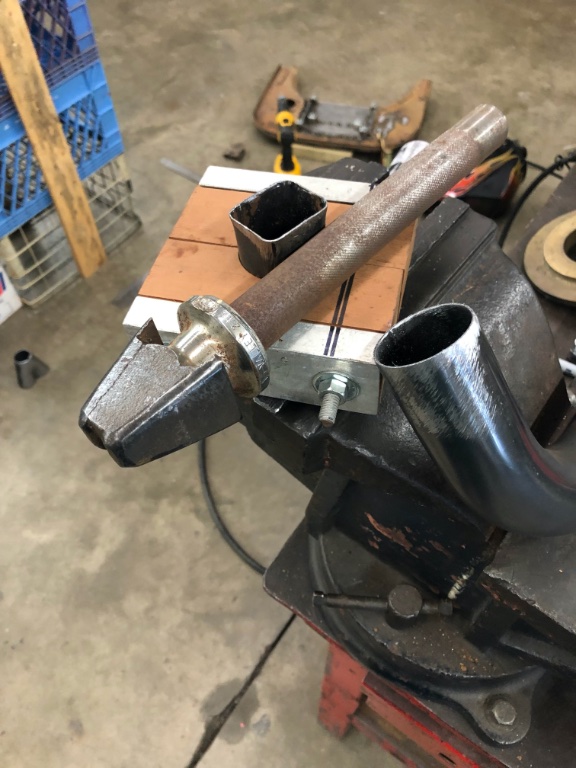

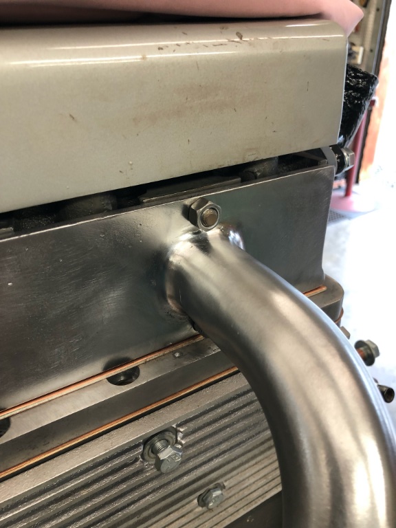

Very nice job. As a retired Boilermaker welder I understand the amount of grinding and polishing it takes to smooth out the weld zones. When I worked at the Nuclear power houses we had to make all our welds look like that. It's hard to see in the picture, but it appears you added a 1/4 turn "twist" to the lower header support. Little details like that make the brackets stronger and add one more little design feature to the project.. Again,very nice job .........
