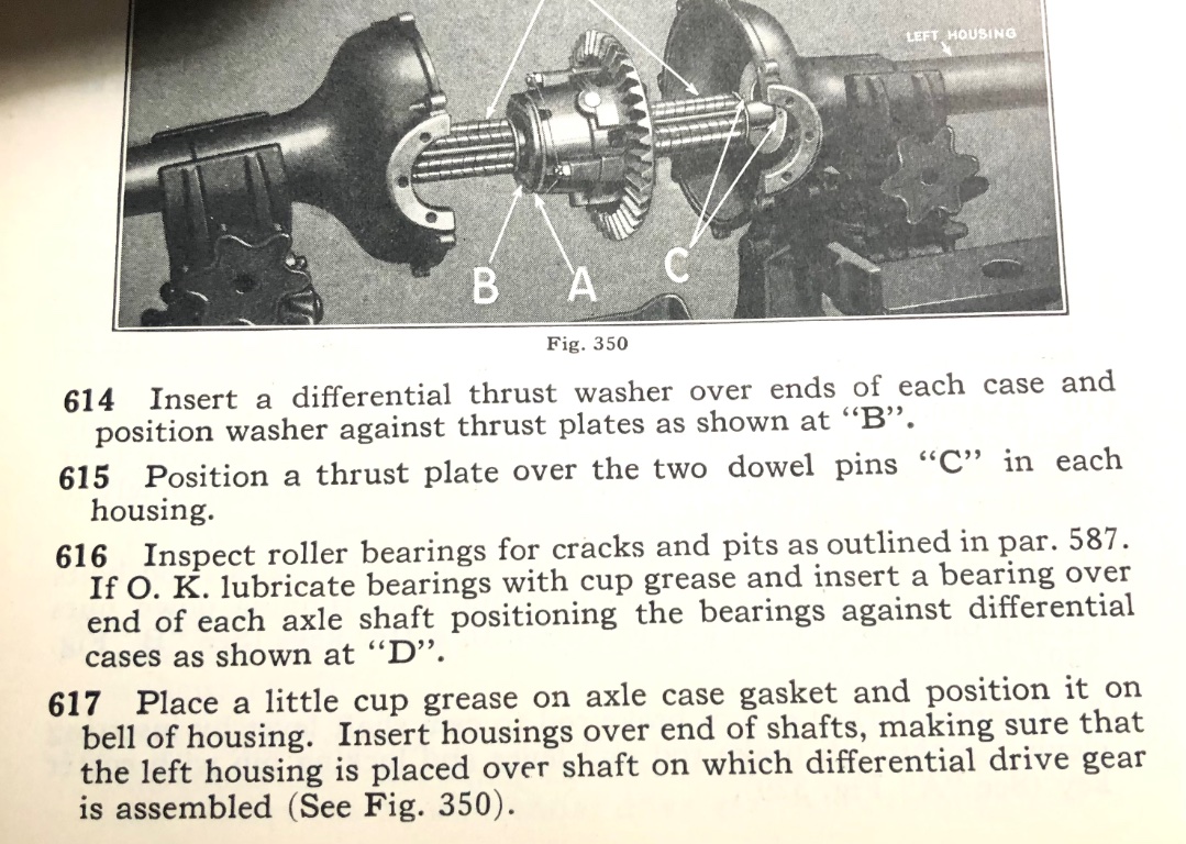

Ford added a housing gasket in 1919, so in fact we are leaving them out and just using sealer. The gaskets between the pinion housing and center were not used, and are shims to adjust the depth of the pinion gear.

Maybe anecdotal, but I have parted out MANY rear ends.
Never seen any signs of a gasket between the housings. FWIW.
Something to research further,

I "think" I have, but in truth, really was not paying enough attention to log it into my memory. :lol:

Paragraph 617 notes to place that axle case gasket ;)
