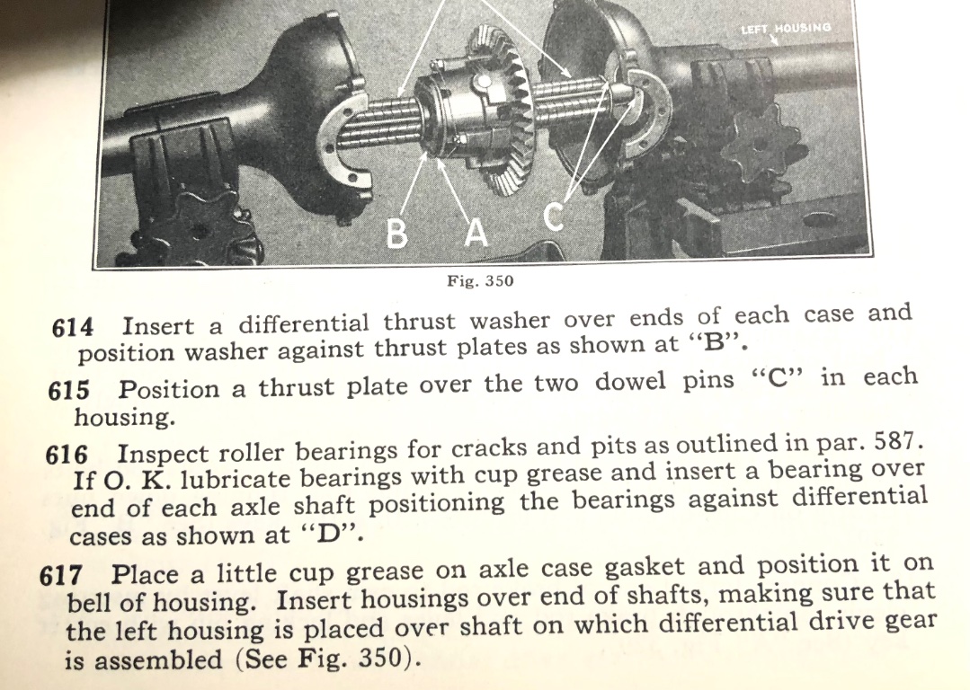

Re: Gaskets
Ford added a housing gasket in 1919, so in fact we are leaving them out and just using sealer. The gaskets between the pinion housing and center were not used, and are shims to adjust the depth of the pinion gear.
- Posts: 5159
Re: Gaskets
Maybe anecdotal, but I have parted out MANY rear ends.Mark Gregush wrote: ↑Wed Dec 01, 2021 2:07 amFord added a housing gasket in 1919, so in fact we are leaving them out and just using sealer. The gaskets between the pinion housing and center were not used, and are shims to adjust the depth of the pinion gear.
Never seen any signs of a gasket between the housings. FWIW.

- Posts: 4048
Re: Gaskets
Paragraph 617 notes to place that axle case gasket
