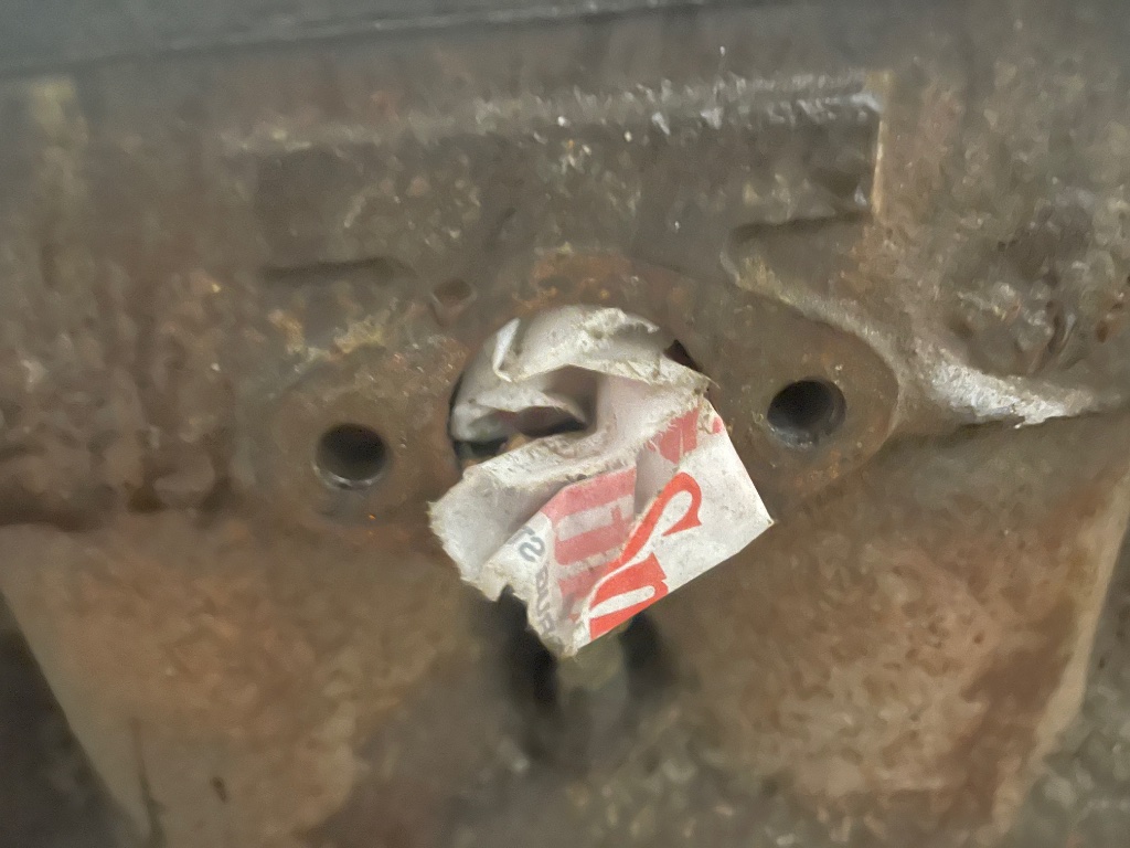

Thanks for the reply’s thus far. I’ve attached photos of where the Serial Number should be stamped and of the peddle assembly. Washington State titles the vehicle by the year it was built and they have titled this as a 1925.

Guess I missed a photo.

Just to the rear of that serial number pad is USUALLY a motor casting date, that can tell you a lot.

The size and shape of the serial number embossment and what appears to be a circular casting date marker indicate that the block is likely a 1917, 1918, or 1919. And most likely a 1919 as most 1918 and earlier blocks had the straight casting date. There were a few TT truck and later replacement blocks into 1920 without the generator, however Ford phased the no generator blocks out rather quickly to simplify inventory control. The round casting date continued on generator blocks through much of 1921, and was discontinued on USA blocks soon after that. Canadian blocks continued to have casting dates, and circular, for several more years.

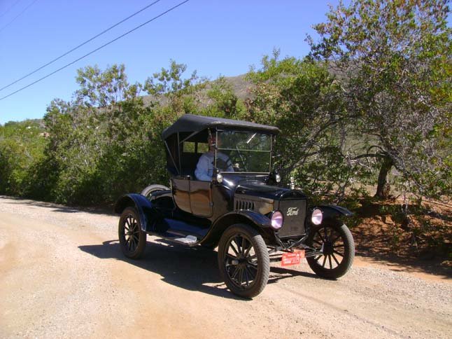

1922 seems to have been a year of transition from the two man top to the one man top. The windshield also changed and the radiator changed from the low radiator to high radiator. So It is quite possible that some of the plants used up their existing parts before making the change, so there were both styles being sold at the same time. And some states dated their model year from the year it was first sold so toward the end of the year there would have been some of the next year models being sold and some of the last year styles being sold. I know a friend who has what he calls a 22 and it has the later type top and windshield. My 22 roadster has a low radiator, a steel firewall and a 2 man top.
My friends 22 touring on right. Notice he has extended the windshield posts because he is quite tall.

The Casting Date Circle appears to have been mutilated too.
