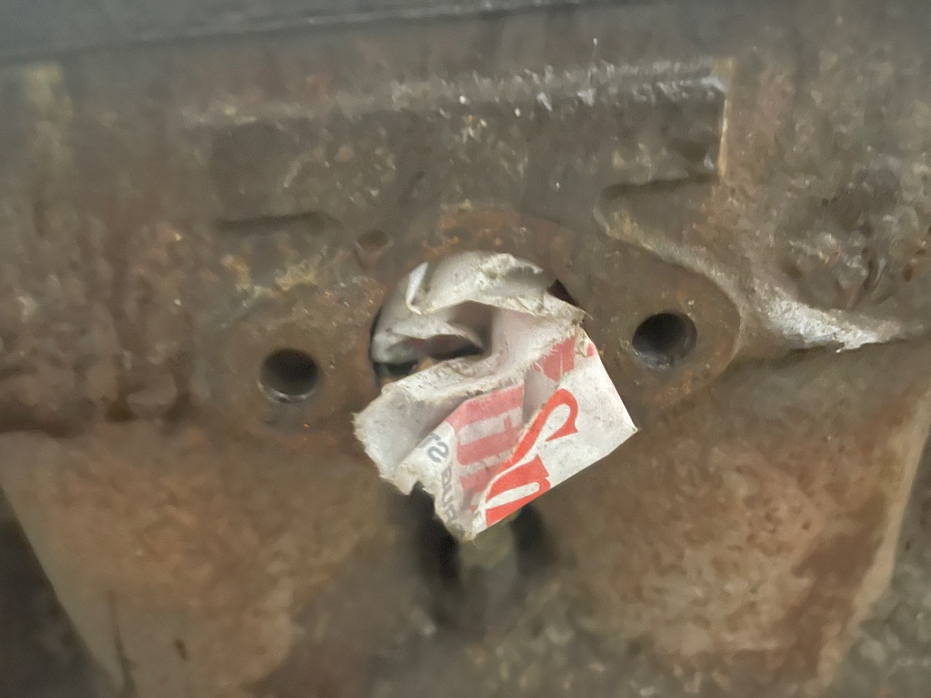

Thanks for the reply’s thus far. I’ve attached photos of where the Serial Number should be stamped and of the peddle assembly. Washington State titles the vehicle by the year it was built and they have titled this as a 1925.

Just to the rear of that serial number pad is USUALLY a motor casting date, that can tell you a lot.

The size and shape of the serial number embossment and what appears to be a circular casting date marker indicate that the block is likely a 1917, 1918, or 1919. And most likely a 1919 as most 1918 and earlier blocks had the straight casting date. There were a few TT truck and later replacement blocks into 1920 without the generator, however Ford phased the no generator blocks out rather quickly to simplify inventory control. The round casting date continued on generator blocks through much of 1921, and was discontinued on USA blocks soon after that. Canadian blocks continued to have casting dates, and circular, for several more years.

The Casting Date Circle appears to have been mutilated too.
