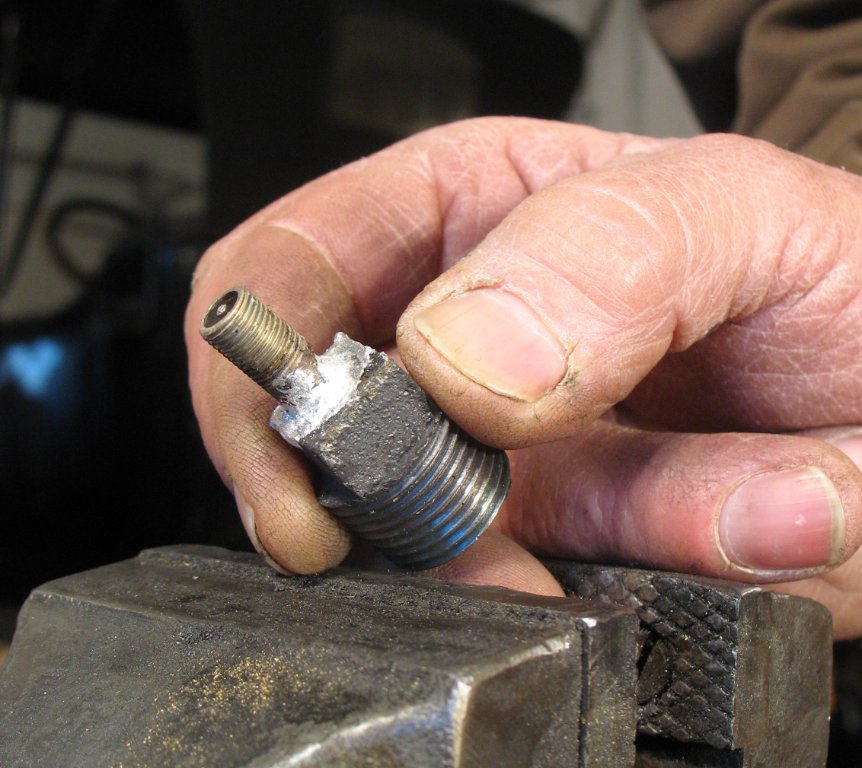

What Scott said. Google 100 psi pressure gauge and take your pick. Take the 300 psi gauge off your tester and replace it with the 100 psi. You will probably need to make an adapter with 1/2" npt thread.
My tester had a tire fitting, so I soldered the business end of a Schrader valve into a 1/2" pipe plug.

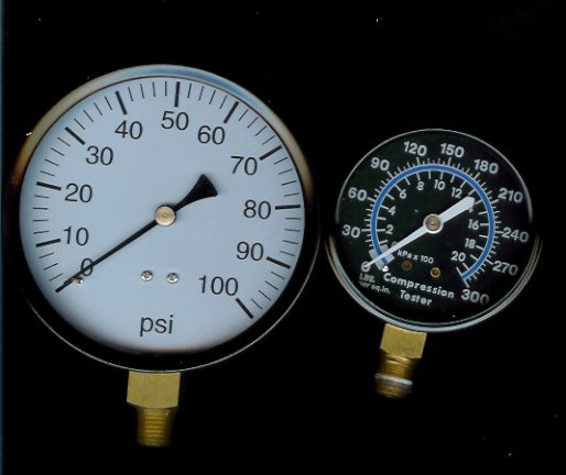

Compression Gauges.jpg (31.03 KiB) Viewed 3643 times
The best choice is to buy a cheap one from Harbor Freight, remove the 300 psi gauge, and buy a 100 psi tree sprayer compression gauge from Tractor Supply.
The most accurate area of those gauges is the center third dial area and 50 psi is the most likely reading.
The device also has a valve to hold the pressure and a button to release it.
You will also need a 14 mm to 3/4th inch pipe thread adapter, like is used for modern spark plugs in the Model T engine.

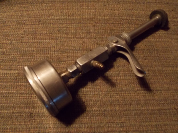

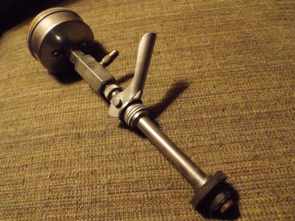

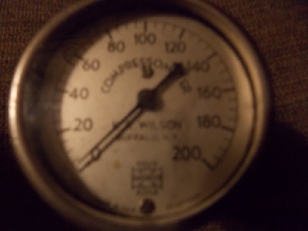

This would probably be the period correct one to use, it's a K R Wilson and the tip fits into the plug hole and expands when the lever is brought down against the stem it most likely had different rubber tips for other applications. Jim
