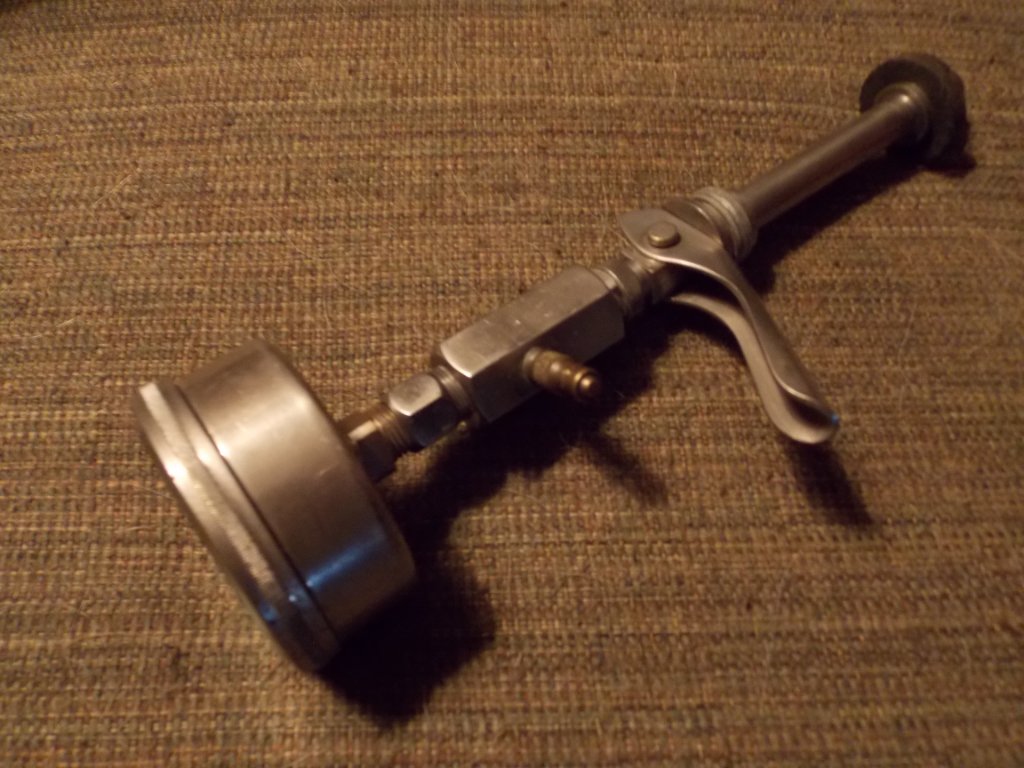

This would probably be the period correct one to use, it's a K R Wilson and the tip fits into the plug hole and expands when the lever is brought down against the stem it most likely had different rubber tips for other applications. Jim
