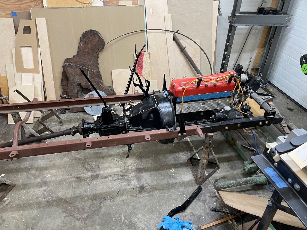

I have a nice Muncie transmission that I got from a friend who passed away a few years back. Is in good shape and came complete with the special U joints and the cutdown torque tube and drive shaft. As you can see in the photo, it’s going in my 26 speedster build. What I don’t have is a manual for this transmission. I see that there used to be a reprinted manual available for them. If someone has a copy of this (digital or paper) they could send me I would appreciate it.
Also, does this take an odd bearing between the input and output shafts like the warford?

The Muncie bolts directly to the back of the T hogshead/pan. There are no adalpter plate etc as used on the iron case Warford. You stated you had the special ujoints- only the front uses a special ujoint with the female end shorter than a ford u-jont. The rear uses a stock Ford u-joint, but there is a female-female square hole coupler that you need for the rear u-joint. This coupler adapts the Ford u-joint male end to the male output shaft on the Muncie.

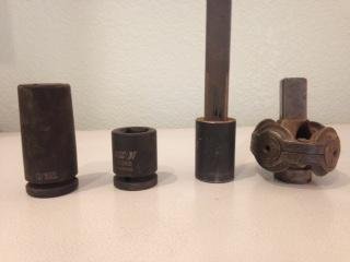

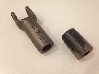

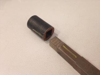

Hi Steve, Sorry I didn't explain the two duplicate pics are of the output adapter I made & the yoke I made it from. The next two are of the input adapter I made to replace the U/joint for the input. ( its not cut to length yet ) and some of the impact sockets that can be used to make them. They are 13/16" square bud wheel inner lugnut impact sockets ( the sockets are used to tighten wheels on big rigs to 500 lb.ft. )to fit the Muncie and the square is 7/8" cold rolled steel milled to fit in the socket & the output of a model T. This makes a input much like a Warford. I have more Muncies that U/joints. The first Muncie I purchased had one on the input made out of cut up T U/joints. Crude but appeared to have been used for quite awhile.
The front flange assembly has to be bored out to accept the socket but that should be no issue if using the sealed bearings. These are not original ideas of mine they have been past on to me from others. With testimonials that they work. Past performance is in no way a garantee of future results. All the parts used are capable handling more torque than a T can produce.
Craig.

Thanks, Craig. Makes sense now. Fortunately I have a good condition U-joint and the rear adapter so don't need to make anything up. Well, maybe a rear support. Have to figure that one out.
