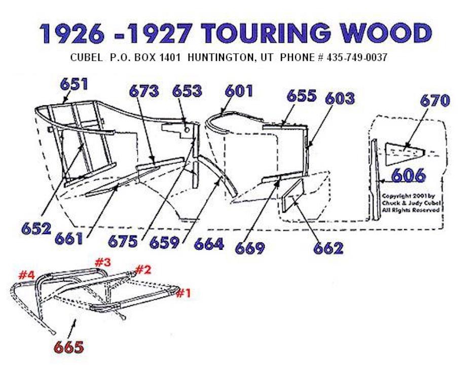

So I've been using this to see where all the pieces go.
Thomas is the area you are talking about where there are C channels listed as 659 in the picture above for the side upholstery?
Or is it 675 and 603.
Also one last question. Number 670 do the bolts that hold the windshield to the car go through this block of wood?

Re: Do 26/7 touring seats have a wood frame?
I will attempt to take some photos showing the differences this week.
Using the front seat as an example, the wood pieces 655 and 603 will not fit on my late '26 Touring. Instead of wood, there are four stamped steel channels front and rear that fit the curve of the interior side panels. While the car is titled as a '26, the body is probably more correctly 1927. Similarly with part 670, while my '26 roadster has a spot for that piece of wood along with a separate riveted tab to secure it, the later bodies have a modified stamping that has an integral tab to retain the top of the cowl upholstery.
So, 670 may or may not be in your car depending on when it was built. Your windshield stanchions are held on with 6 - 5/16" carriage bolts, metal to metal. No wood is involved here. When putting your car back together, assemble the RH stanchion before installing the gas tank as the wrench clearance is tight.
I have found many differences between the 1926 and 1927 open car bodies such as the interior wood, doors, tank mounts, sills, and cowl. I believe that 1927 served as the basis for the 1928 cars and have found things like the latches interchange.
Tom Miller

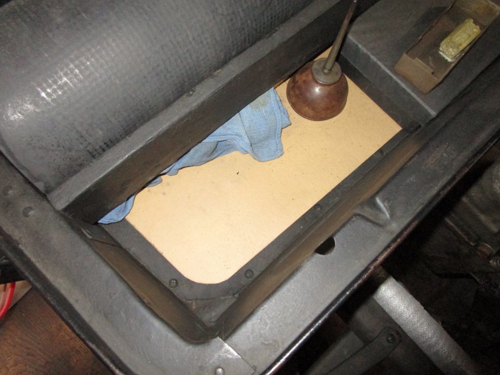

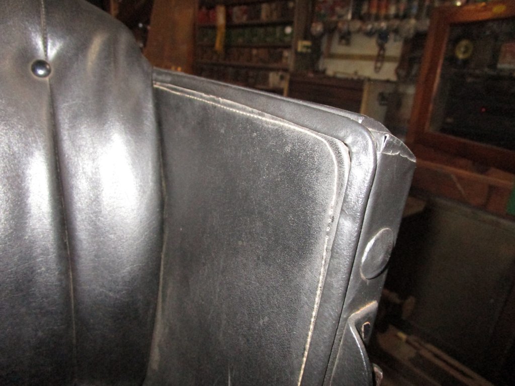

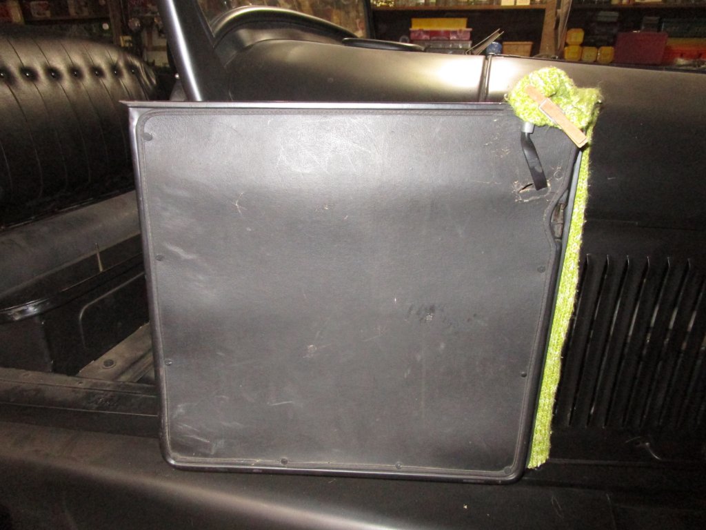

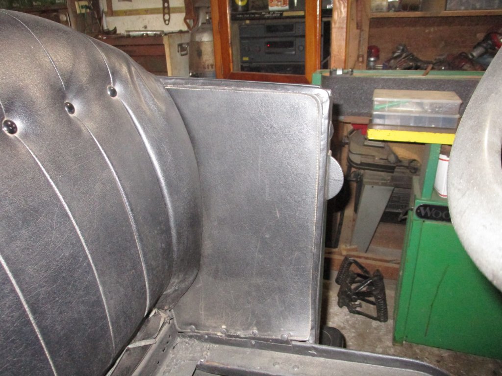

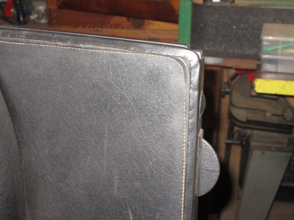

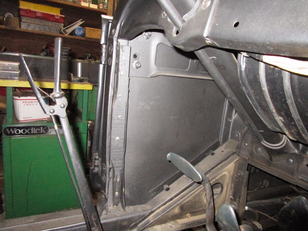

dobro1956
- Posts: 1437
- First Name: Donnie
- Last Name: Brown
- Location: Hills of Arkansas

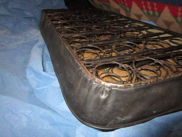

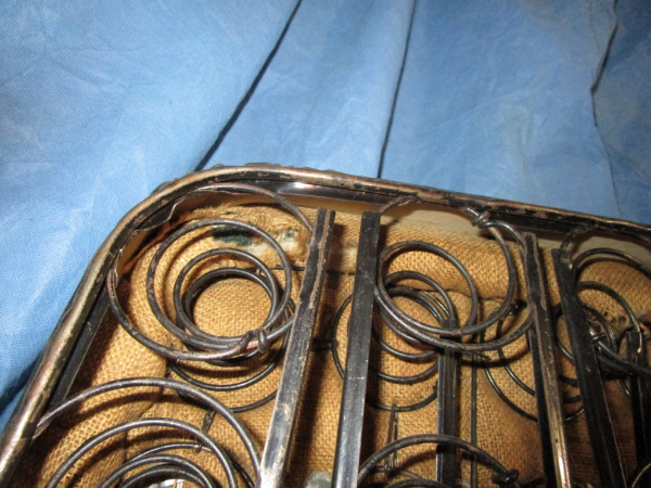

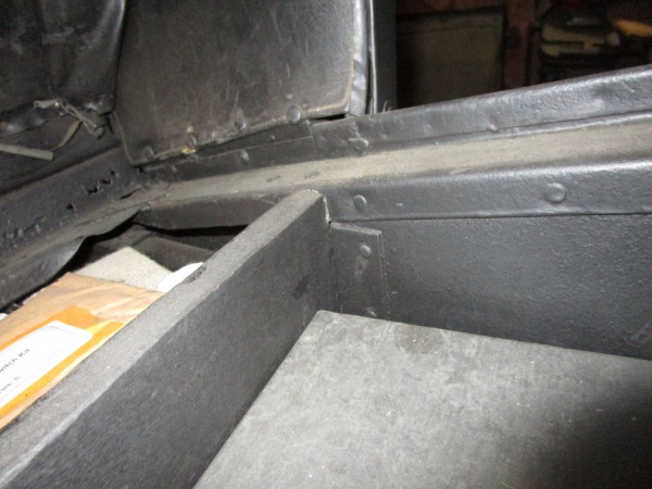

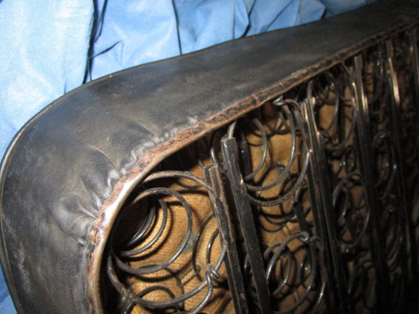

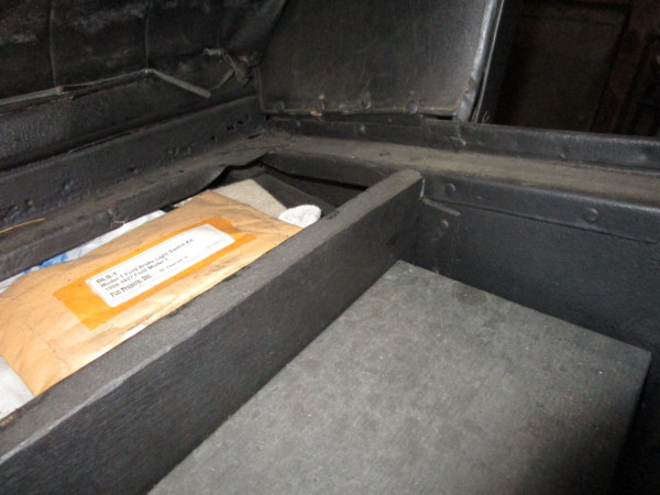

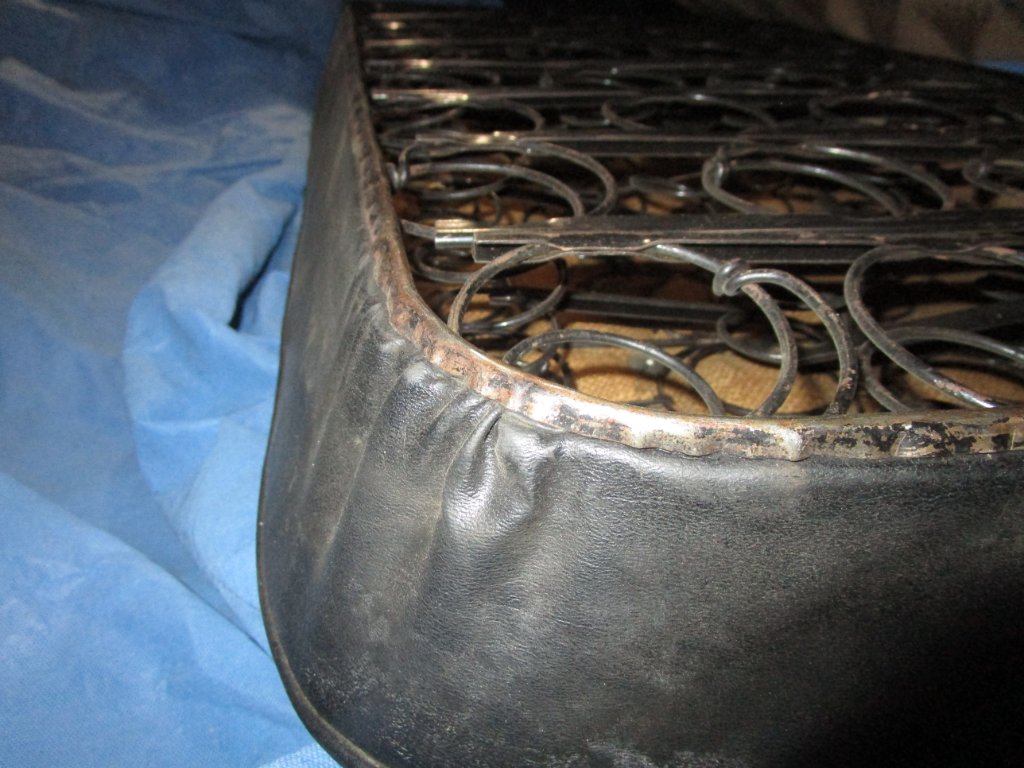

Here are a few pics showing the springs, the cross board, how the hip panel attaches, the cardboard "anti-rattle" panel in the bottom of the seat frame, etc. .... If you need any more pics, let me know. My car is a very late 27. All the wood in my car is original. Early to mid 26 did not use the little metal trim channel around the hip panels. I'm unsure as to the exact "date of change" They just tacked in place similar to the door panels. Front and rear seat areas are basically the same.

Wow this is all very helpful. I'm going to take a hard look at the car now that I know there is a difference.
