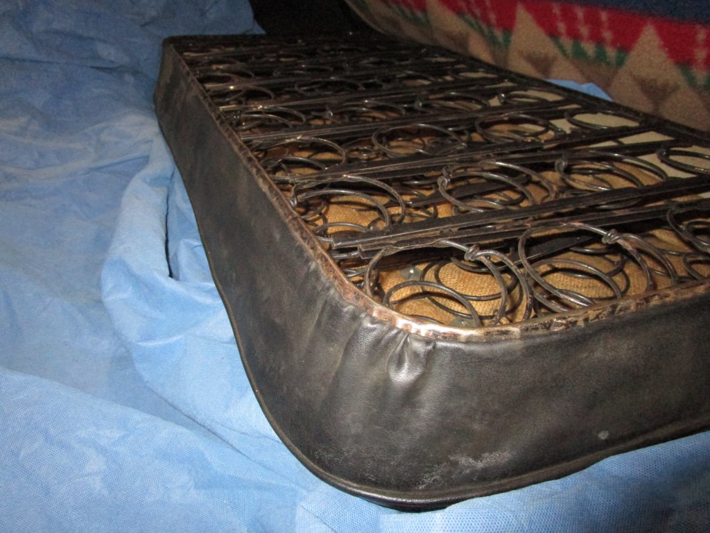

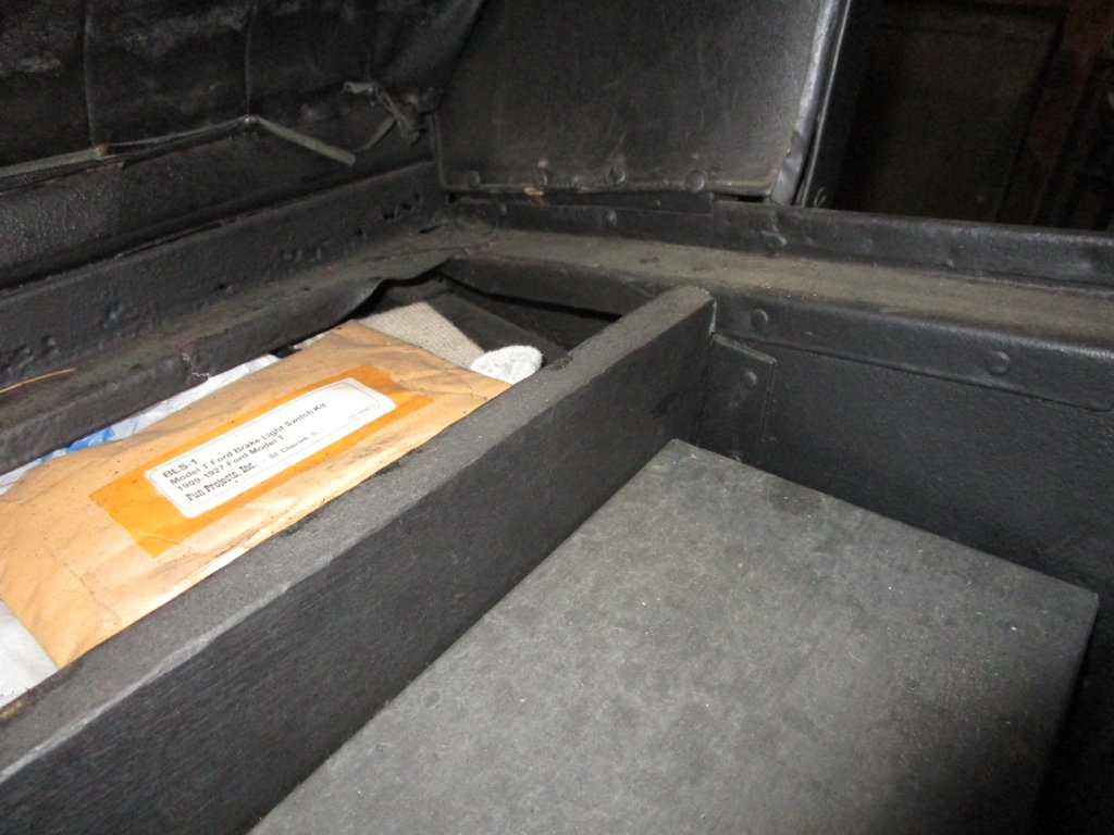

The seat frames are all metal except for a wood cross board (aprox 1 x 4) that fits into a slot on each side of the seat frame.

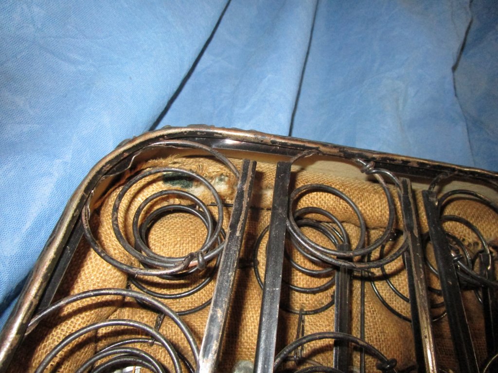

The springs are all metal. There is no wood frame attached to the springs. There is a sheet metal channel/flange at the bottom edge of the springs that the upholstery tucks into and then crimps/folds over to hold the upholstery in place. I don't think any hog rings are used.

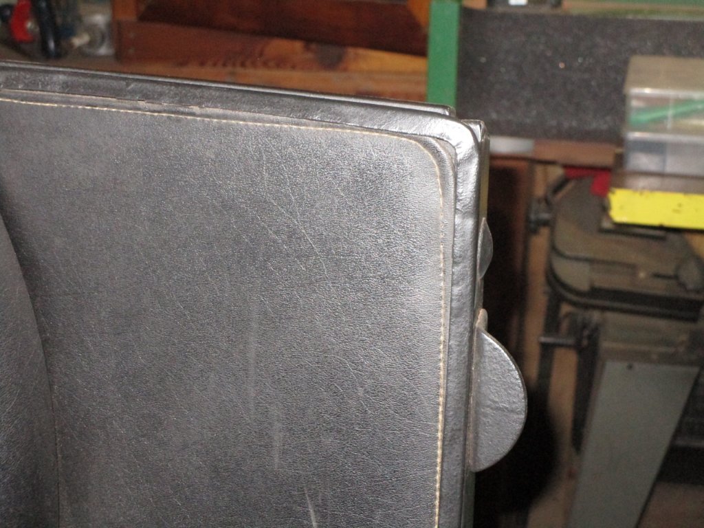

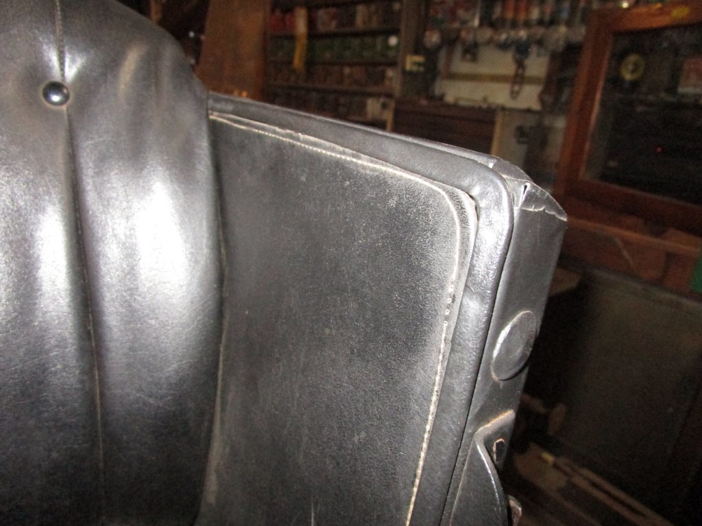

Here are a few pics showing the springs, the cross board, how the hip panel attaches, the cardboard "anti-rattle" panel in the bottom of the seat frame, etc. .... If you need any more pics, let me know. My car is a very late 27. All the wood in my car is original. Early to mid 26 did not use the little metal trim channel around the hip panels. I'm unsure as to the exact "date of change" They just tacked in place similar to the door panels. Front and rear seat areas are basically the same.
