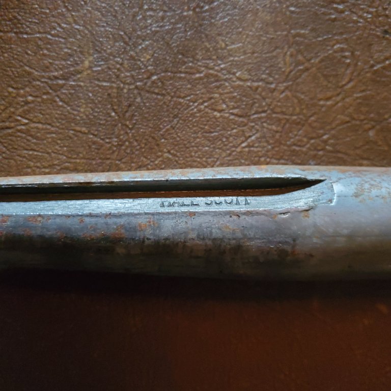

Responding to the why question. Perfecto axle has an inner roller bearing just outside of the shifting fork. The axle needs to be ground in that area to 1.062-3.
Also the sliding clutch rides on the axle with a close tolerance, about 5 thou. The axle must be small enuf the entire length to permit installation of the sliding clutch. Actually only the area from the inner bearing surface to the axle gear needs to be ground as that's the area the bearing rides and clutch travels. . The outer length between the two bearing surfaces only needs to turned small enuf to allow installation of the clutch.
RGould1910
Posts: 1240
Last Name: Gould
Location: Folsom, CA
Re: Axle question
Post by RGould1910 » Thu Dec 30, 2021 5:47 pm
Perfectos were originally sold with one axle ground the entire length. I have an original. It's stamped with the name Hall Scott in the keyway.

Post by RGould1910 » Thu Dec 30, 2021 6:10 pm
Axle keyway.
