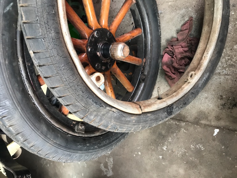

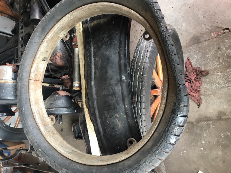

On the way to work this morning I found this rim in the trash, I think it has a broken repair crack , I don't have any spare, welding it is no problem for me. The tire on it says 30/3-1/2 oversized, I haven't tried to put air in it yet

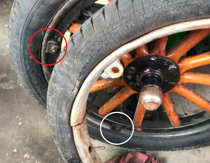

Nice dumpster diving! What the heck were they thinking! Looks like the lugs on it will match up to your wheels. I would not see an issue welding it up and using for a spare. I would mount to a wheel and at least tack weld a couple of place to keep the correct size. Lot depends on the condition of the clincher edges. Don't think I would use that tire.

It's a Hayes rim and the other one in your picture is another brand, but it may fit your wheel. You can try it and see. The tire is toast. When you remove the tire inspect the clincher edge closely. If it's rusted sharp, that's probably why it was in the trash.

Check the inside of the rim for a manufacturer. Not all rims fit all felloes. Not sure what you have.

It's Hayes. The other one isn't. Firestone, Kelsey, and Cleveland rims all used camps before rims were standardized. I agree, the way to find out if it fits is to try it. When Ford first started using demountable rims they did not interchange. Later they did.

What about the valve stem. Is it in the same position in relation to the lugs?

If the inside of the rim isn’t rusted badly and the rim is still good on the edges that’s a keeper. I’m pretty good at welding and that is a fixer upper as far as I can tell. At the very least for a spare.
