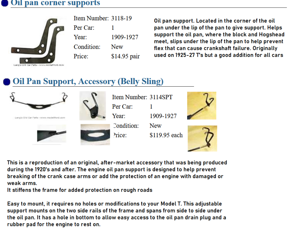

That is not stopping the pan twist which causes broken crankshafts.

Ken is right. Just get those 2 accessory L brackets that fit under the crankcase with 4 bolt holes each that stabilizes the tranny cover, pan and block. I’m at the Dr. office now but someone will list the correct nomenclature.

George House wrote:
Tue Jan 04, 2022 11:12 am
Oil Pan Supports
L's https://www.modeltford.com/item/3118-19.aspx
Belly https://www.modeltford.com/item/3114SPT.aspx
