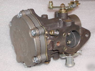

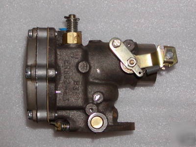

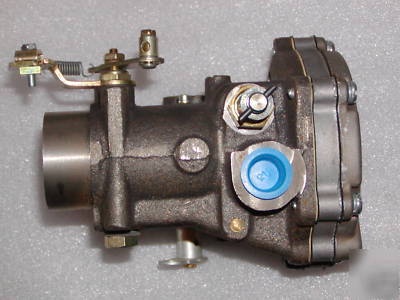

The MTFCA Carburetor handbook shows a Zenith Butane Gas carb with an Algas 880 regulator on pg 17 figs 48 and 49, the caption on the photo states "LPG Carburetor" and "LPG Individual Components". I think a propane forklift carb for a similar displacement engine might suffice. jb
And no visible water connections, perhaps b/c Butane, not Propane is the fuel?

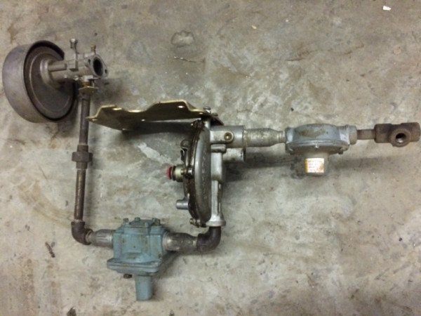

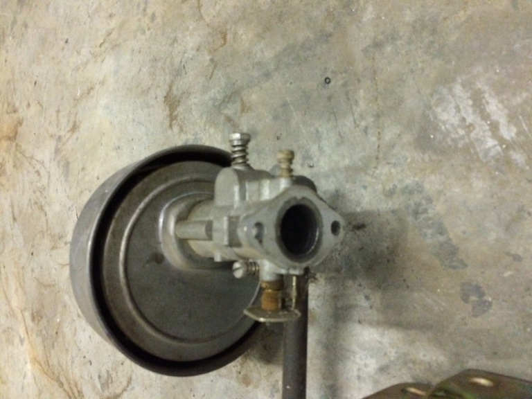

A couple of pictures of the propane carb and regulators that I picked up at a swap meet a couple of years ago. The plan was to install on a “vintage” generator I have.
Bryant
Posts: 1219
First Name: Bryant
Last Name: Shafer
Location: Myersville Maryland
Re: Propane conversion/ ethanol free gas drift
Post by Bryant » Mon Jan 10, 2022 2:52 pm
That’s pretty neat. Looks like an old Kohler engine carb. Sort of.
