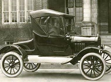

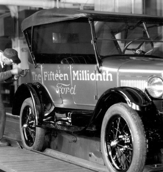

Many period photos of later year Model T' runabouts and tourings typically have the top up, and often have no top prop arm and saddle, just a plug over the top prop hole. Noticed in a factory photo of the 15,000,000 Ford, at the end of the assembly line there is someone installing the top prop arm, almost as an after thought. I cannot find anything regarding top saddles leaving the factory. The parts are in the parts manual, they must have been provided by Ford, wonder why they were not installed at the factory. Any older threads about this? I cant find them. There is no evidence that there were ever arms and saddles on my 24 runabout, and the rubber plugs are missing too. Anyone have an original rubber plug they can provide a picture of?

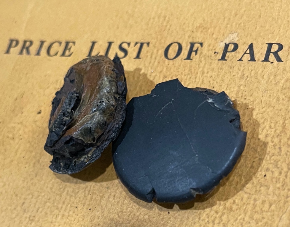

Did that. I didnt find any documentation noted, mostly conjecture. I had heard there was a top down delete discount/savings. Again no documentation. My first T is a 1 owner family early 23 touring. It had the plugs, black painted as described. Both hard like Bakelite. they chipped away to remove. I think the rubber hardened as does a tire of that age. No evidence there were top saddle rods ever installed. Similarly, there is an original 25 roadster in the chapter that has been in the same family since 41.

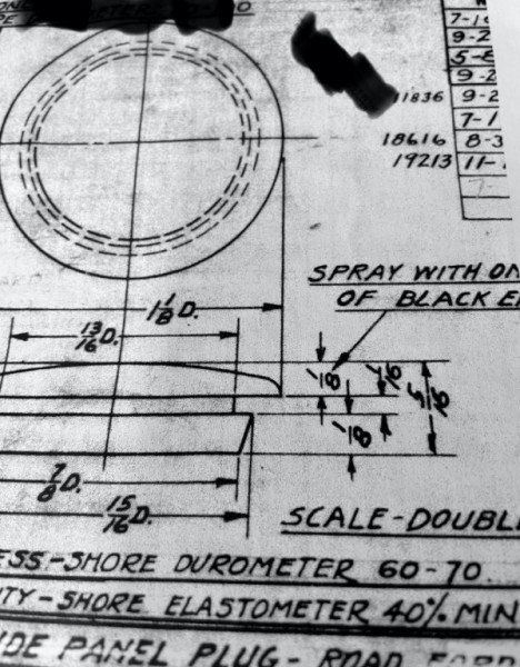

I assume that when the L arms were discontinued, and the top saddle arm holes created in the body, the rubber plugs were introduced at that time, because Ford realized most people didn't put the tops down. The original plugs were two pieces, a hard rubber plug fused to a soft rubber back that had a groove in it to hold it in place. We were able to reproduce that plug, but made the entire plug from soft rubber.

These plugs are original to my 1925, found as is in a barn in 1977. They were in an old tire patch canister, and they are aged for sure. Did place them sometime ago in the side panels when the arms were out. Used some glue on them to keep from falling out on the road, so that is the brown residue now on them.
The rubber plugs by Ford for the rear panel opening is all rubber according to the print. The only 'hard surface' would be the specified 'Black Enamel', sprayed with one coat, on the outer surface only, to be painted on the rubber plug to match the exterior of the Ford.

Great documentation on the plug! Thanks for posting Dan.

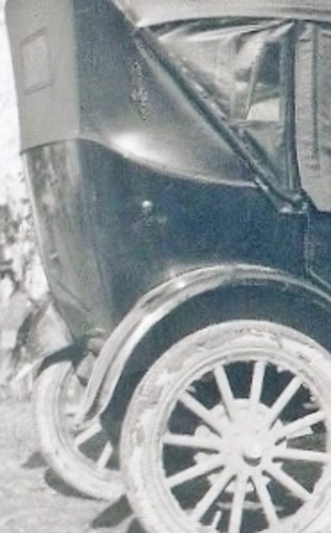

Agree with you there too. IMO the top prop rods and saddle and straps were just placed in the car, same as the tool kit, perhaps in a box? Anyway, these parts are needed for the top to be folded down. The mention of these in in the Service Bulletin. Aug 1922, with illustration on how to raise and lower the new 'one man' top. Without these the top irons would collapse over the back of the body!
And many photos show the plugs in place on original cars, when the top prop rods aren't in use. If you have ever squeezed yourself into the trailer/garage when the T has the T "up" and those rods are sticking out......well.....I have hit my elbow on 'em a few times, and they can snatch your shirt too!

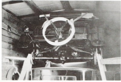

The plugs were placed prior to shipping, as the top prop rods could cause trouble in shipping a car. Photos seen show the top assembly fully released and hung down and secured with strapping......that way the top assembly took way less room in packing in the car.
Note this Improved runabout in the box car, top is hanging down and certainly not be supported by the prop rod, saddle and its little leather straps for shipping.

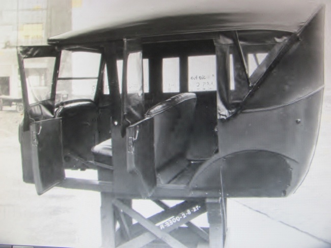

Plugs in place.

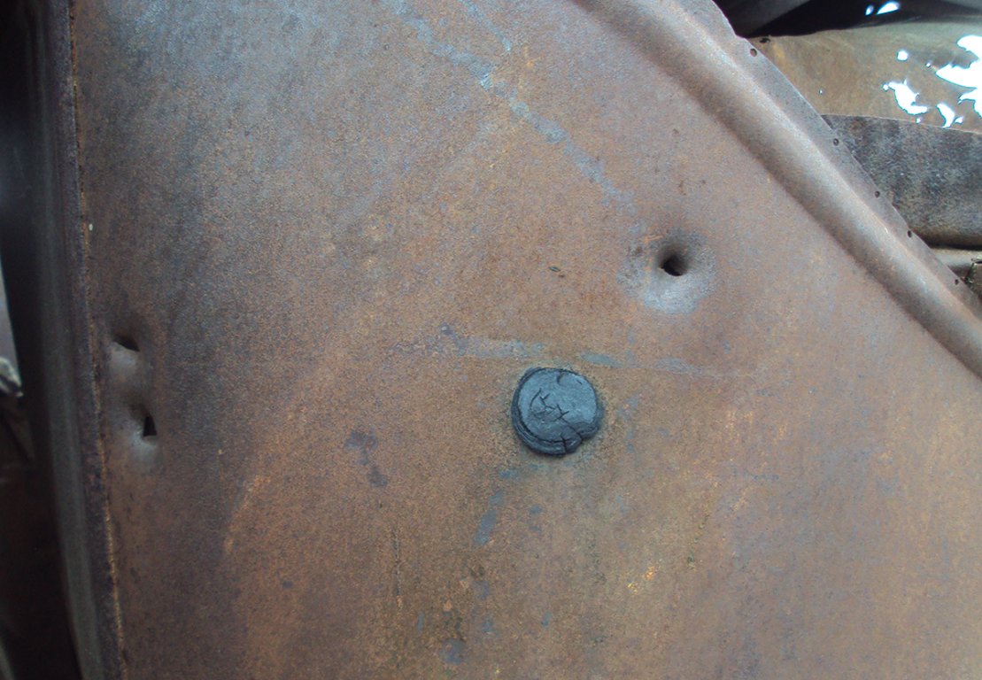

And a black painted plug on an Improved Car with color finish.
