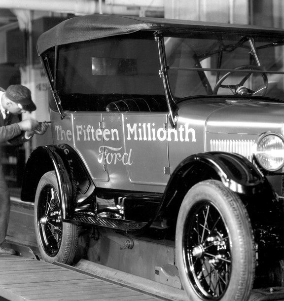

Many period photos of later year Model T' runabouts and tourings typically have the top up, and often have no top prop arm and saddle, just a plug over the top prop hole. Noticed in a factory photo of the 15,000,000 Ford, at the end of the assembly line there is someone installing the top prop arm, almost as an after thought. I cannot find anything regarding top saddles leaving the factory. The parts are in the parts manual, they must have been provided by Ford, wonder why they were not installed at the factory. Any older threads about this? I cant find them. There is no evidence that there were ever arms and saddles on my 24 runabout, and the rubber plugs are missing too. Anyone have an original rubber plug they can provide a picture of?

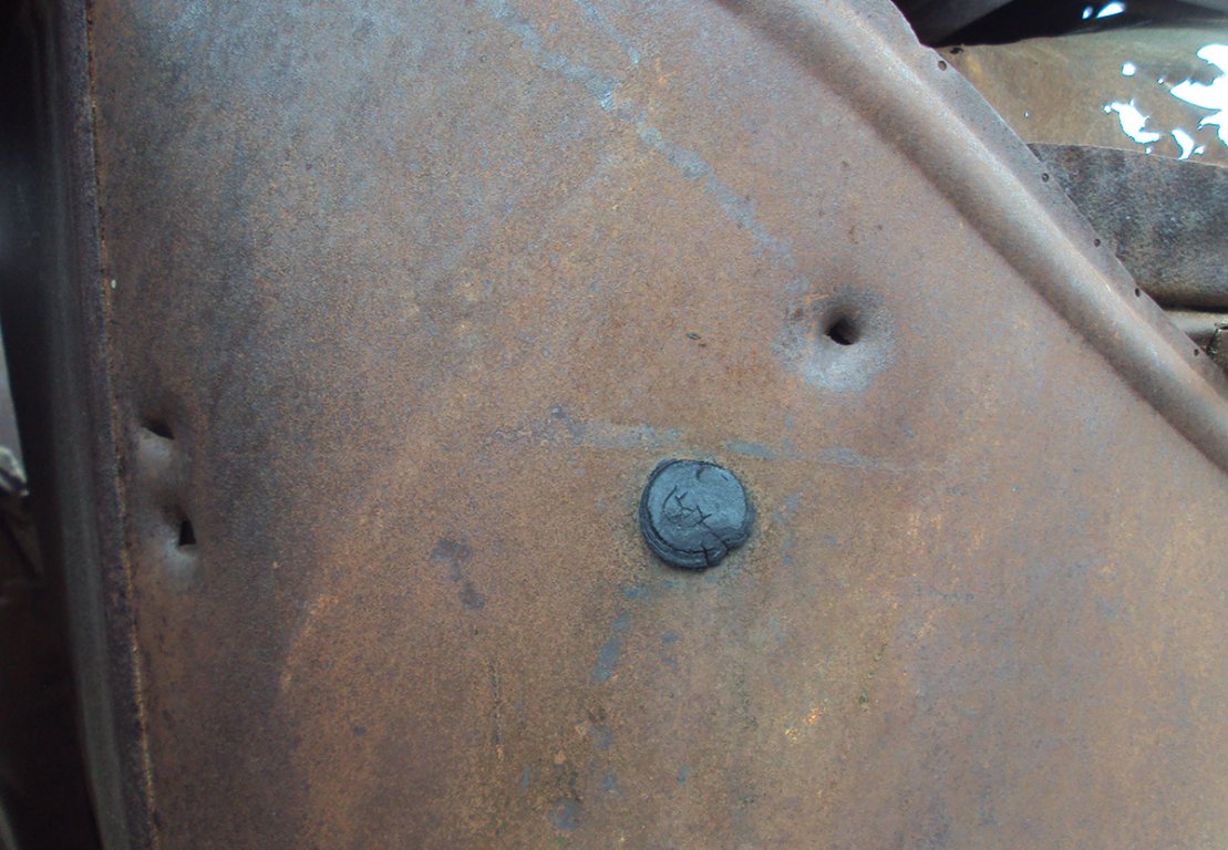

I assume that when the L arms were discontinued, and the top saddle arm holes created in the body, the rubber plugs were introduced at that time, because Ford realized most people didn't put the tops down. The original plugs were two pieces, a hard rubber plug fused to a soft rubber back that had a groove in it to hold it in place. We were able to reproduce that plug, but made the entire plug from soft rubber.

This one's been there for 97 years.

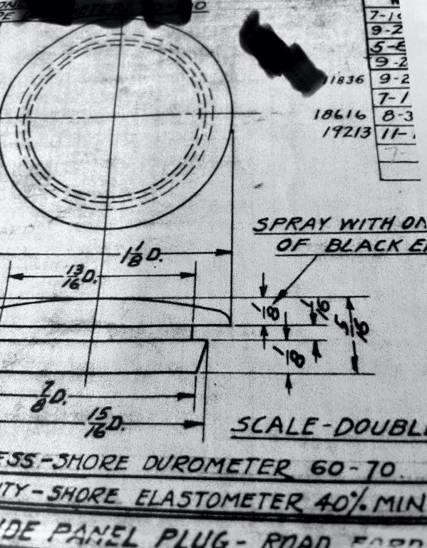

These plugs are original to my 1925, found as is in a barn in 1977. They were in an old tire patch canister, and they are aged for sure. Did place them sometime ago in the side panels when the arms were out. Used some glue on them to keep from falling out on the road, so that is the brown residue now on them.
The rubber plugs by Ford for the rear panel opening is all rubber according to the print. The only 'hard surface' would be the specified 'Black Enamel', sprayed with one coat, on the outer surface only, to be painted on the rubber plug to match the exterior of the Ford.
