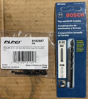

Read in past posts about drilling out, cleaning and sealing carburetor passage ports. Works great and easy entry in the future….😊
https://www.amazon.com/gp/product/B0849 ... UTF8&psc=1
https://www.amazon.com/gp/product/B07DS ... UTF8&psc=1

That is how I have doing for a while. 7 blocks to ACE, buy the Allen heads, tap the hole, install with some sealer, done. Or find brass stock, cut, install, peen, file as needed. Guess it's a wash. :D

regarding screws, I'm not a fan. I can plug a hole in 1/4 the time anyone can drill/tap/install a screw, and the repair will be undetectable in fit, finish, or performance as from the factory. On NH's, I consider a screw to be a blemish and not a feature.

To each his own. On the NH only one set screw is on the outside, is filled when painted and faces the engine so is unseen and certainly not a blemish….

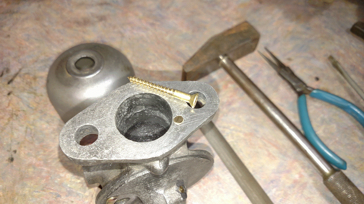

My source for brass plug stock was a package of brass wood screws that I had on the shelf. Those are easier to find than brass rod.

Brazing rod is plentiful in my shop.

Why not just mix up a bit of JB weld. Press a little in the hole and strike off the top and let cure. Seals it up but is easy to drill out in the future if needed.
