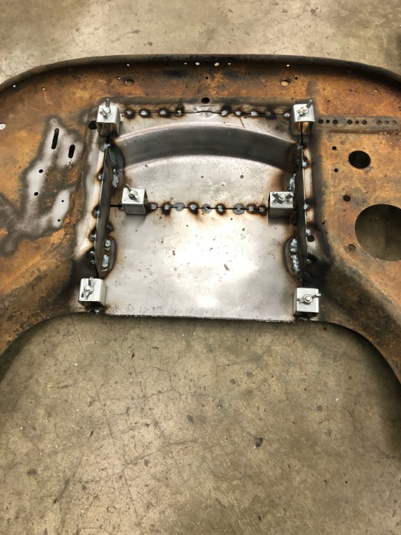

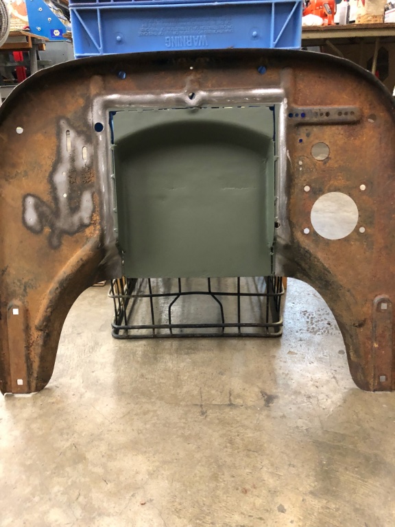

Hank Lee posted some pictures in the past showing how he moved the existing firewall "hump" vertically and then added material below that to give clearance for a head. Perhaps he will repost those here. Obviously you loose your coil box, but....
- Posts: 5603
- First Name: Henry
- Last Name: Lee
Re: Overhead installation
If you want to use an original coil box.., just dish more for the insulator(s) clearance! Been there done that!
Hank

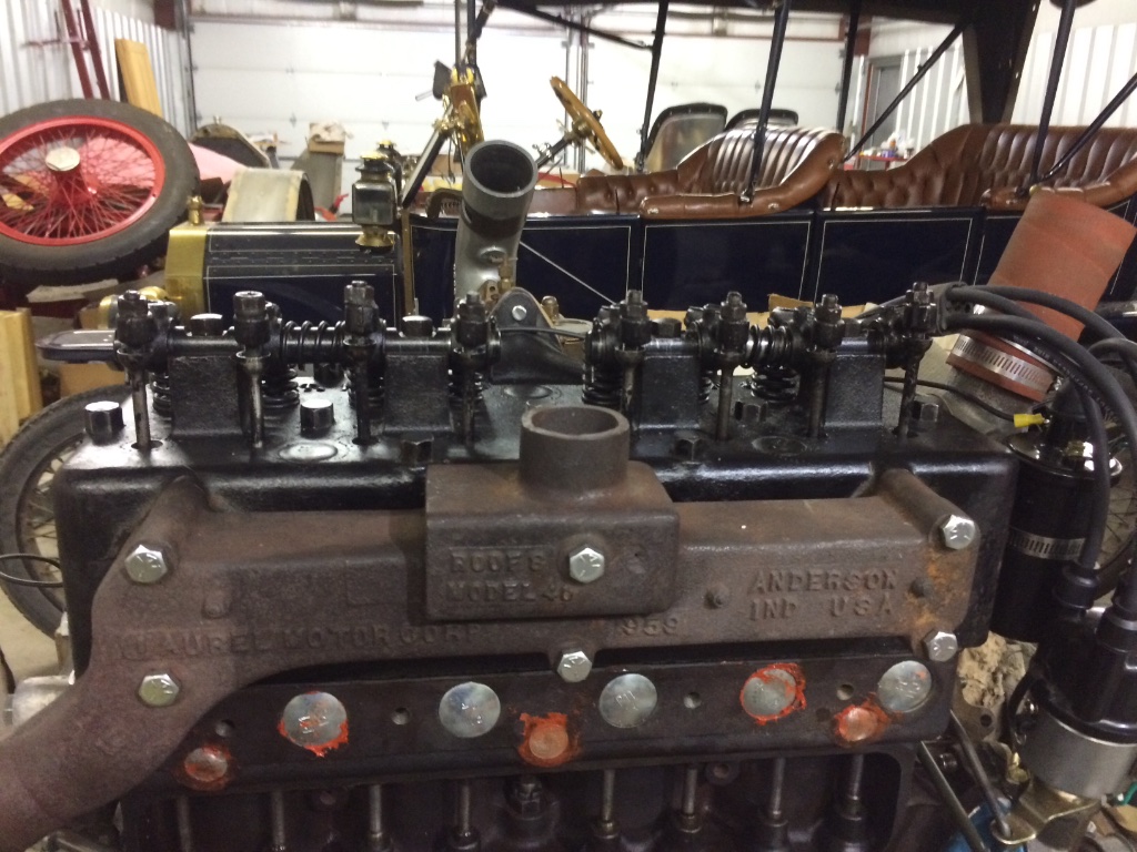

I had no problems installing the Roof 8 ohv on my 26-7 4 door. Yes I had to install a flexible choke cable and adjusting the mixture was no longer possible from the dash. And yes it needs a fuel pump!
The 4 door of course has the fuel tank under the seat (the same as yours). A cowl mounted gas tank would likely be a problem, but I haven’t looked at it.

You can see that the head really doesn’t extend past the rear head bolt!

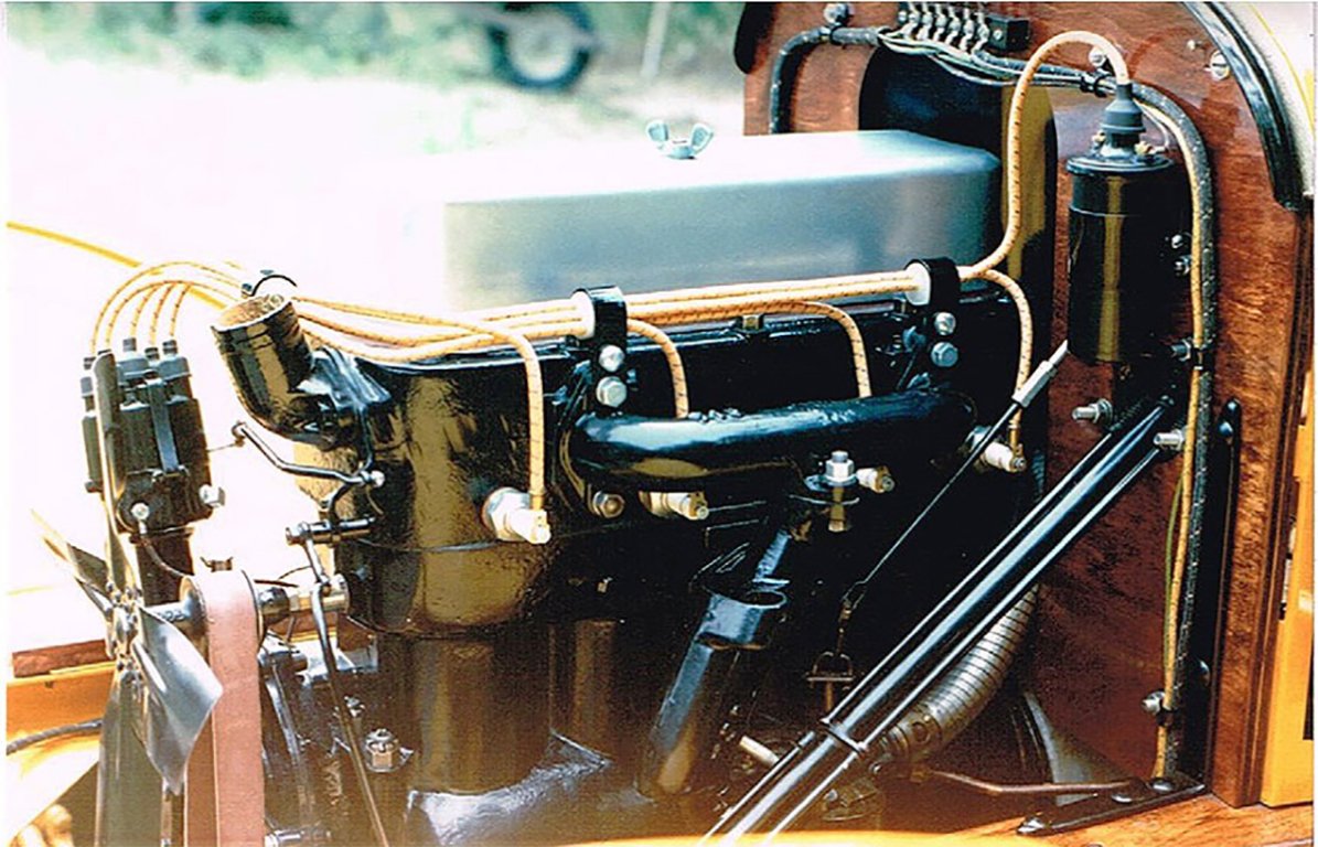

I made a wooden firewall for my Roof in my speedster and gave room for the cover to be removed.
P. S. Nice work Henry.
- Posts: 5507
Nice clean engine compartment, well laid out Rich!

I did the same as Hank. Had a local hot rod metal shop put recess in metal firewall. Looks really professional and almost "factory". I run a dizzy, so coils removed leaving more room for recess.
Dave
Dave

Henry the Roof Liberty Eight does extend behind the block and prevents the firewall from sitting down properly.
